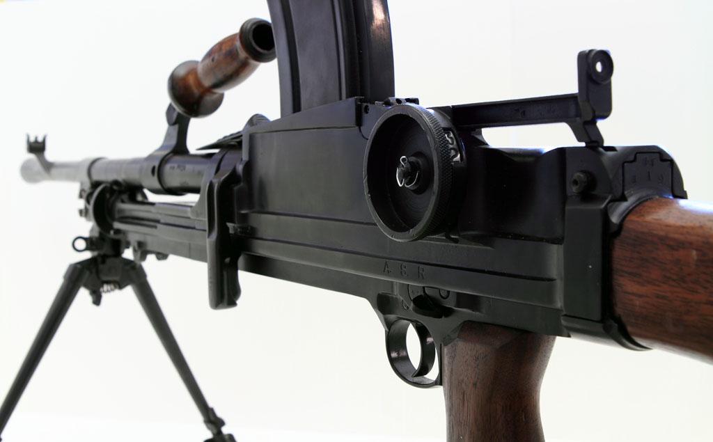

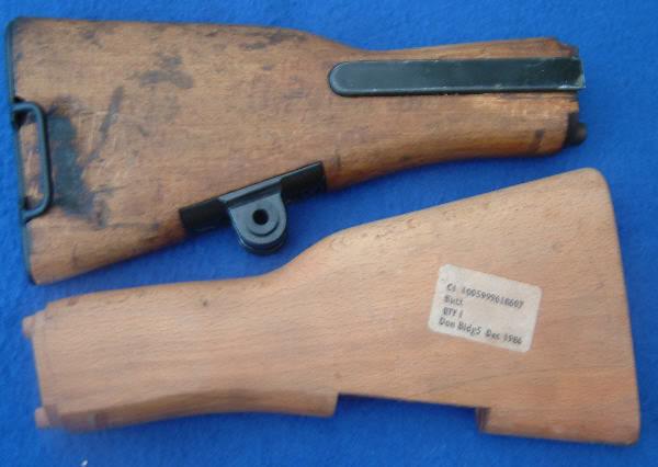

    Pic of MK4 butt -
    MK4 butt assemblies and gas shields are still available.
    Peter might make a comment regarding that not all L4A3's were fitted with a MKI cocking handle ?
    ATB Kevin

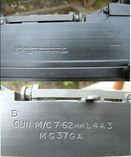

    Although I can't see them properly the markings don't look like the markings we recognise. Ours always(?) went
    GUNS M/C 7.62m/m L4AX
    MG xx GA
    with the old markings barred through with two lines
    To illustrate -
    atb Kevin

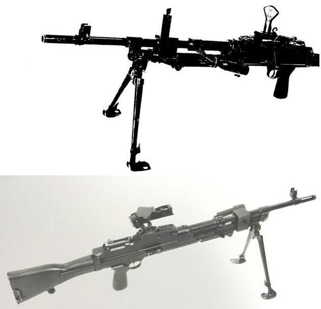

    Was the L4A8 (with GPMG legs ) more stable than the L1A1 with the GPMG legs fitted ?
    While the subject of sights has been brought up (appologies in breaking into the thread) any idea how the MG3 AA sight was attached to the body in the pic below ?Unfortunatly the pic showing the fixed side is very poor.
    ATB Kevin

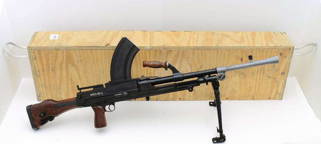

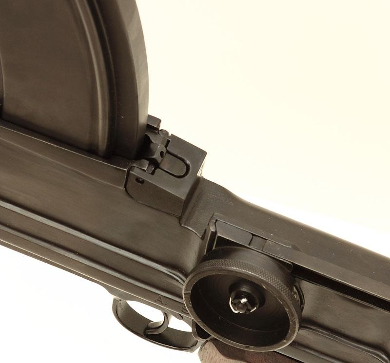

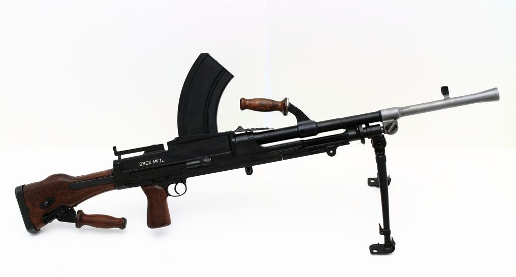

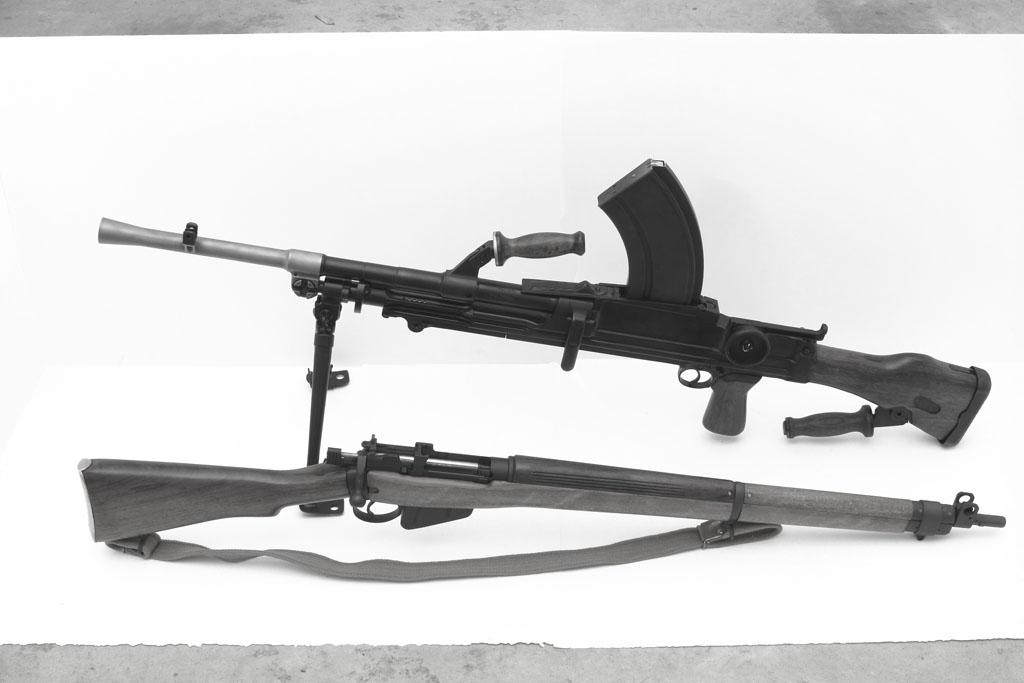

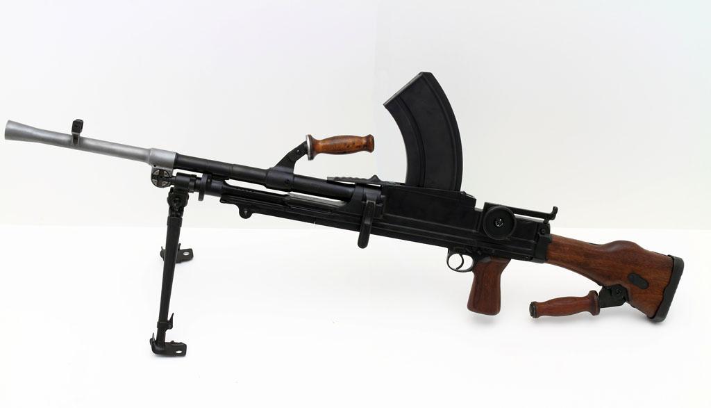

    ok just a couple of quick shots until I can take some more detailed pics. I need to learn how to disassemble the gun before I can get shots of firing mechanism.
    with little brother (No4 MkI)
    and what we ended up doing for the magazine lock.
    Anyone have pointers on bren disassembly?
