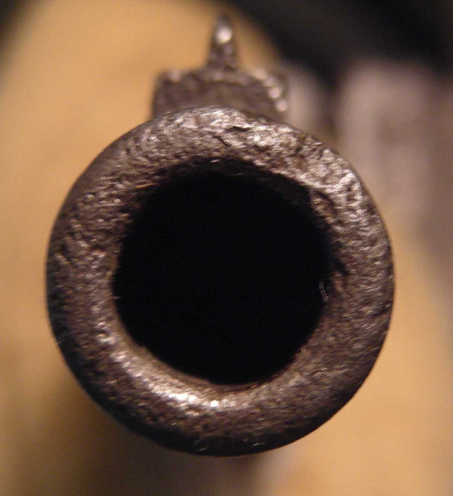

    You have already seen the "before" picture of a muzzle in a dire state.

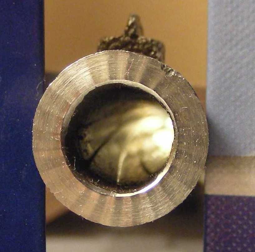

    This is the front end of a Mauser 1871 that Has Seen Better Days. However, the bore looks several grades better than that, and I thought "this is an ideal object on which to try out some muzzle recrowning." I won't tell you just yet how that was done on a lathe that is too short to take the barrel - sensitive mechanical engineers unaccustomed to backwoods methods might have a shock. Anyway, it now looks like this:
    - A first approximation, of course - the smoothing out and rounding of the crown on the outside would have been cosmetic, with no effect on performance, and I was keen to try it out. In fact, I rather like the pattern created by my juddering cutter (if I had deliberately wanted to get it to look like that, you can be sure I would not have succeeded) and may well leave it as it is! And the beast gets all shots on the paper without keyholing, so it's not dead yet!
    Looking at the above - if that can work, then the Argentineicon Rolling Block ought to be a piece of cake!
