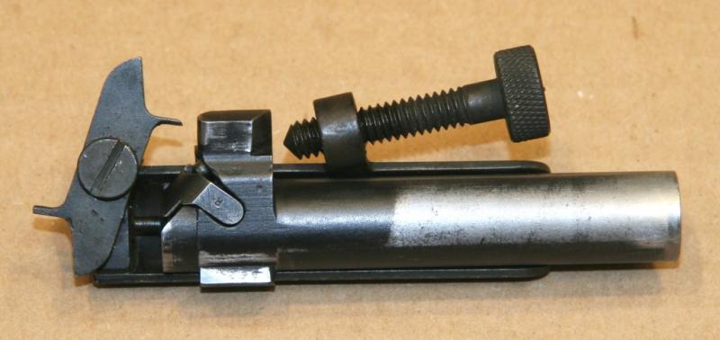

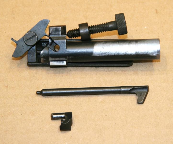

    Come on Charlie. It's a swivil into place pawl and a thumb screw. Not very hard to learn. After a few times it's nothing.
    It's a bit more if you are taking out the extractor spring and plunger and ejector and spring. There are some things to watch when you put the extractor spring and plunger back in, so as not to have it turned goofy.
    You have a bolt and tool.
    Put the bolt in the tool. Pin of the tool against the ejector.
    Turn the Pawl into place. Use the solid end not the split end.
    Tightening down on the thumb wheel, the pawl lifts and holds the extractor plunger up and out of the way.
    Push out extractor and pull out firing pin.
    Look at your parts. Although in this case you can see it is a Rock-Ola extractor in the bolt.
    Reverse to put back together.
    Pretty darn easy even for an old guy like me.
