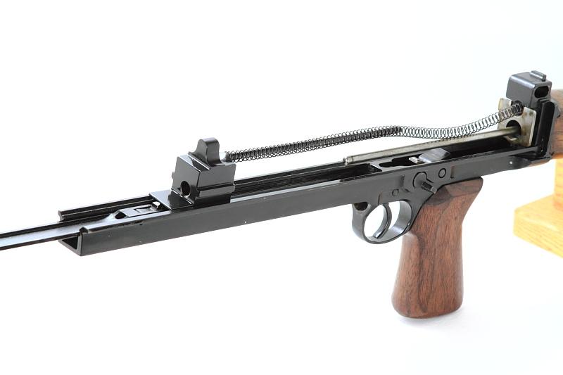

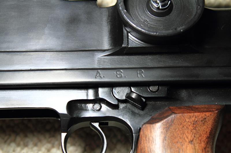

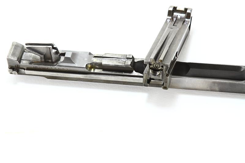

    had a few free moments to play around with the Bren and was able to separate the upper and lower half. I have to admit, I'm impressed by the design of the Bren -- pretty easy to strip. The more I study it the more I'm impressed by the thoughtful design.
    anyways, I don't know how the original internal parts look, but here are a few of my modified semi auto. Is it enough for you experts to figure out how it was converted?
    The part where the spring attaches to looks new to me.
    The Bolt

    It would APPEAR that the added block & the relieved area of the piston post. Indicate that this has become striker fired. The cut down butt slide welded in, would prevent a normal Buttslide from being inserted with a NON modified selector also. It appears that a pin has been inserted to block the selector from being pushed into the Automatic position. ( I used to grind off the bottom portion of the 'D' shaped lug. That went through the 'window' of the sear. This prevented auto fire & alo welded the head of the axis pins of the trigger & Sear. Thus preventing removal of the semi -modded componants) As it is now a closed breech fired weapon, Cartridge Head Space is even more critical! Nice conversion, & neat tidying up of the appearance finish. Well done you lucky begger!
