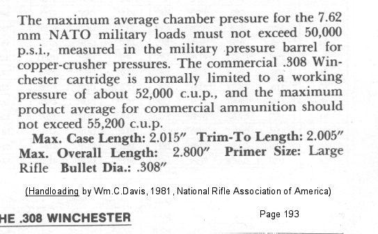

    The M1916's were originally made for the 7x57 cartridge, which has a SAAMI working pressure of 46000 c.u.p. (51000 p.s.i. - piezo) and a minimum proof pressure of 61500 c.u.p. (68000 p.s.i. - piezo). SAAMI working pressure for the .308 Win. is 52000 c.u.p. (62000 p.s.i. - piezo), so while the M1916's may have less reserve strength than arms originally made for the .308, it's inaccurate to state that they were proofed to only 45000 psi and therefore inherently unsuitable for 7.62 NATO/.308 Win. pressures. Nevertheless, prudent handloaders preparing ammo for the M1916's ordinarily use data for the .300 Savage, a cartridge of nearly identical capacity but with working pressure of 46000 c.u.p..
    Before we get into a kerfuffle about 7.62 NATO vs. .308 Win. pressures - here's the straight dope from a reliable source:
