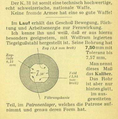

    Has anyone reloaded for this round? The bullet diameter used seems to be .306" and I can't find anything very close to that besides the standard .308". What will work? Thanks

    Groove diameter tolerance for new-manufacture 1911 and K31 barrels was 7.80 to 7.87mm (.3070857 to .3098416 inches). The 1911 pattern Swissicon military bullet's major diameter is nominally a fraction over .308". Whoever made you believe .306" is more appropriate doesn't have the facts straight.

    So a .308 bullet is acceptable? Is this what most use? Sorry for the questions.

    Yes. it is the bullet you have to use. I reloaded for my Gewehr 1911 with the components from Lapua and my favourite ones were the 170 grs Lock Base and the 185grs Silver Scenar. Both had great accuracy. I used them the most at 300m shooting and there the 170grs bullet had some advantages. It depends on what distance you will use your rifle. There are some good load data´s for 100m shooting with H&N copper plated lead bullets at their website. But this loads are mild loads so you won´t get them out at 300 meters with any good accuracy. I made good experiences with the VV N140 powder.
