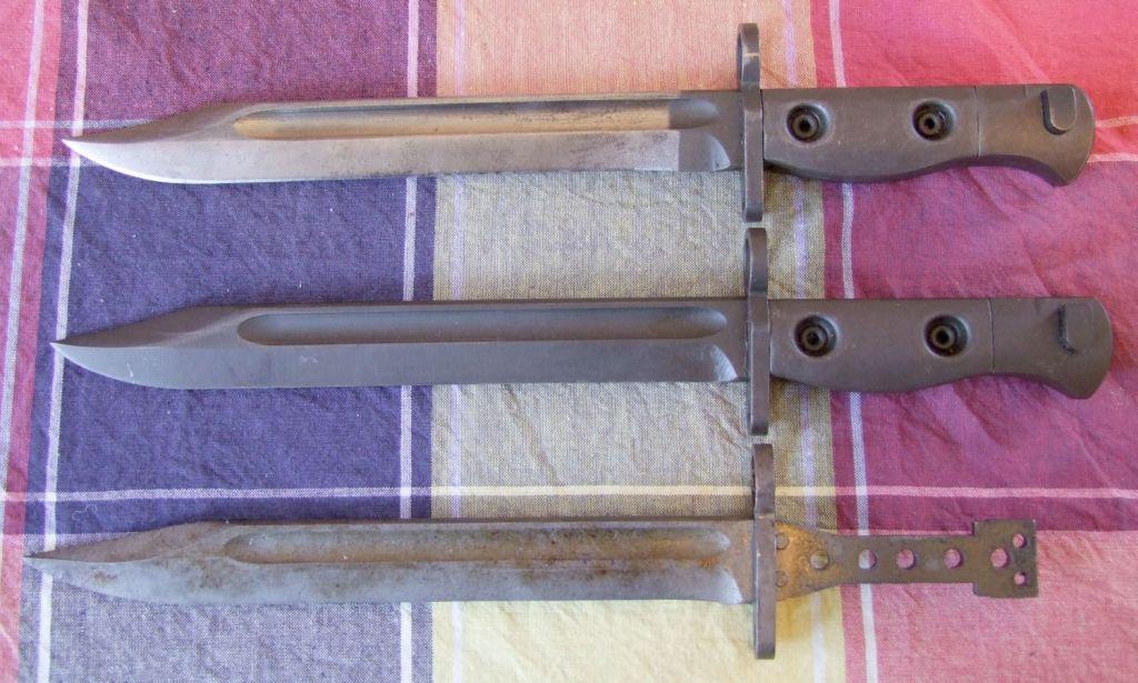

    Thanks for the photos Peter, they help a lot. Here's my observations of the piece.
    The blade and layout is Australianicon L1A2 bayonet as you said.
    The D/|\D is VERY unusual and not normally found on any Australian made L1A2 bayonet in general service. There are lots with serial number/rack number/unit details, but NO Ownership markings.
    I would surmise the '8' is a serial number and that this bayonet is an example/specimen/evaluation item. This would account for the D/|\D marking and s/n number so that its assessment could be linked to the supporting report of its evaluation.
    I've lightened up the pic and can see there is no assembly slot on the underside of the Pommel. This is another feature that was omitted from Australian production, it seems at the same time the bayonet was fully phosphated from 1962 onwards.
    First off I've had a look though the Rifle Steering Committee (RSC) minutes of 1960 (9th) and there's no mention of any sort of modification of this sort proposed by Australia. It dose however detail the acceptance of Australia's wishes to be allowed to change the shape of the end of the Fullers to the distinct 'rounded' shape. This better suited their milling procedures at the time.
    I would hazard a guess this bayonet dates from circa 1961, and is probably an evaluation example sent to Britainicon as part of the RSC procedures. The most likely reason for evaluation is a proposal to change/remove the assembly slot or in this case use a traverse hole through the Pommel to aid in the assembly of the Pommel to the Tang of the Blade to speed up production of the bayonet.
    Its hard to tell from the photo, but in your opinion Peter, is the Pommel brazed or riveted to the Tang?
    Version 2 and Version 3 Australian L1A2 Bayonets (Top to Bottom)
    Australian L1A2 Bayonet Version 2, circa 1960/61 (rounded fullers, 1st inch of blade phosphated, assembly slot on underside of Pommel)
    Australian L1A2 Bayonet Version 3, circa 1962 (rounded fullers, all phosphated finish, no assembly slot)
    Australian L1A2 Bayonet Version 3 onwards, circa 1993 (this uncompleted bayonet was part of the 11 tons of 'scrap' sold off from Lithgow to a US based group in the 1990's.)
