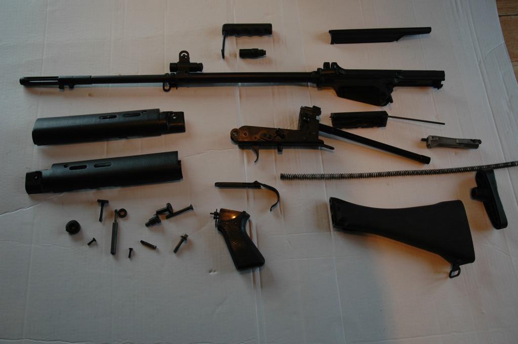

    Guess what I have been doing this morning? .
    Before the start:
    I wonder what happens if I take out this little screw here?
    And after....some will like it better before conversion, some will like it better after. Me? After, thankfully .

    Looks sweet, hopefully my wood should arrive tomorrow. Did your's include the carrier as that is what I am having touble locating? Also David how long did it take to put back together?
