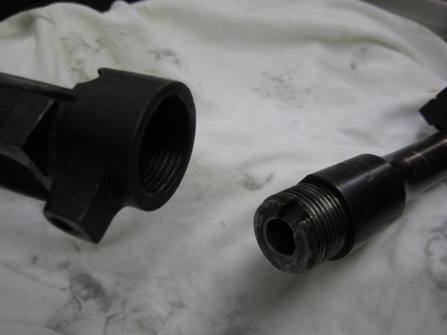

    A picture posted while I am waiting for the barrel to arrive...

    Well, the replacement barrel came and is on the rifle ready to be test fired. The barrel condition is not great, with some frosting towards the end, so I am not sure how it will shoot. But I think I will try it before I look for another. It was not expensive, so I can afford to experiment.
    Was looking on the web and found a website that was proclaiming the benefit of a .303 with the shoulder blown out, the .303 Epps. Wondered if that would be a possibility for my barrel with the rust/wear at the shoulder. Has anyone made up a rifle in .303 Epps?
