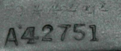

    Nice, but why have the upper and lower serial numbers been removed and renumbered? - and the 'UB' prefix is missing.

    Thanks for comments!
    I will make some detail Photos & post it here. It is full of numbers & stamps (possibly even more, than my SMLE ), some are quite good visible, but some appears ground off or overstamped:

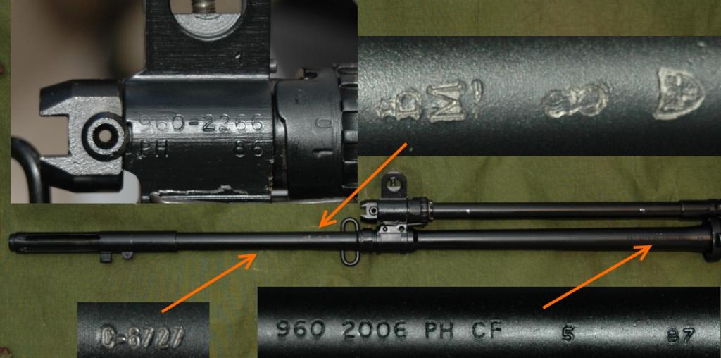

    Here is barrel Photo with details:
    Parker Hale? 1987?

    Britishicon serial numbers prefixed with a U, and the second letter signifies the factory, so:
    UE = RSAF Enfield
    UB = BSA Guns (British Small Arms)
    UF = ROF Fazakerley
    So a UE 59 ********* serial number is RSAF Enfield manufactured in 1959.
    Re the barrel, 960 2006 is the standard part number, PH is the barrel manufacturer as already said, I believe CF is the steel manufacturer - Corby Foundries.

    I understood that these single shot/hand cocking L1A1's had newly made, unported barrels. That can't be the case with this PH made L1A1 barrel, complete with bog standard, presumably ported, gas block. Or is this a genuine, bog standard L1A1? It'll be interesting to see whether the wobbly backsight slide rides up the bed when it's fired

    It's not one of ours, looks like a genuine one
    I bet you a packet of jelly babies the backsight stays put

    David TS, Thank You very much for explanation.
    Today it will be fired for first time. Surplus Ammo has not arrived yet, so i have to try with some handloads.
    Another question: I have read that the Barrel has 6 groove - my has 4
