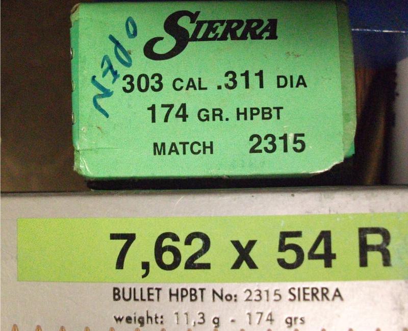

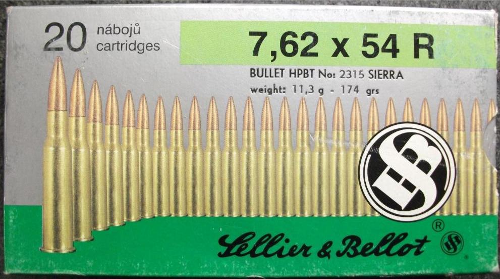

    S&B did a run of Boxer primed, brass cased, 174gr Sierra Matchking bulleted ammo some time back, but it may have been 8-10 years ago. Haven't seen any (for sale) in a while!
    Found a box:
    It used these fine projectiles:
