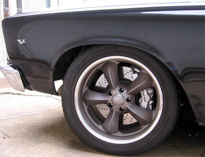

    The welding I did was on the bottom of the gas tube. I did not weld on the barrel itself. The previous owner did some nasty welding and no doubt did nothing for the barrels precision (or lack thereof). I am very aware of what welding does to metal. I weld and machine all kinds of stuff. Sheet metal, steel structures, automotive stuff, tools for my guys at work, etc. I have a good understanding of physics and what temperature does to metals. I bet my life on my welding and machine skills, as evidenced by this photo:
    How many 1965 Plymouth Belvederes do you see running around with twin turbocharged fuel injected big blocks and 14" AMG disc brakes from a 2005 Mercedes S55?

    I like a challenge but I'm not interested in throwing away good parts in exchange for lower performing items.
    The hot rod is powered by an Edelbrock headed 440 wedge. It's got a custom port injection intake of my own design, 1700 cfm throttle body, and 120 lb injectors. The ignition is distributorless and controlled by the EFI system.
    It's street manners are so nice that I drove it from DFW to Green Bay, WI on the Hot Rod Power Tour.
