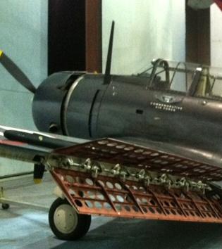

    Apparently the CAF SBD has dramas. Just now got done looking at it. Looks like major oil leak coating the rear flight surfaces. Ailerons and some fairings are off. If it's in for repaint it'll be a little sad as it has a nice weathered appearance right now.
    Are you talking about the oil in this photo? All these radials spew oil constantly and have to be wiped down after every flight. It looks like someone started to wipe it off after it's last flight, but didn't do much. You need to put a big pan under the engine as soon as you stop flying to catch all the residual oil that drips out. Not usual to have a quart or so in the pan all the time. Each cylinder is on it's own in a radial motor and they just leak constantly. You chase the worse leaks, but really worry when it stops leaking (because you're out of oil)
    Cowlings come off routinely - They're under constant maintenance and they were always like that, even when new.
    Are you talking about the dive breaks? (Do you have more photos?) I just checked the Dixie Wing Schedule and the SBD is still on schedule for appearances through the next few weeks.
    It's not likely it'll be repainted any time soon. They did a major livery change to the tri color early scheme about ten years ago and it should remain that way for years. It costs a small fortune to repaint and it isn't usually done unless it's completely worn out.

    That's good to hear. Must have been some "minor" control surface maintenance. But the oil leak was more than usual, so... It's hard to get much info at 3AM

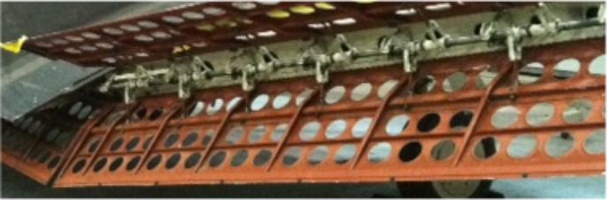

    ETA, no NOT the dive brakes! Ailerons. Much less complex! (I can't remember if they used my tooling to do new dive brake skins back in the '90s or not. I did a static set that hangs in the Naval Air Museum wall, and some for a "real" flying SBD, but don't remember whose- may have only been a partial skin... Sorry, rambling! Trying to remember old stuff!
    ETA2: Note the lack of control surfaces at the far left of the photo outboard of the dive brakes:

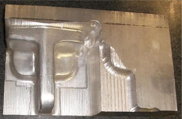

    Some minor updating and some "leftovers" that have turned up:
    The SBD WAS in for a new coat of paint, but I don't have new photos.

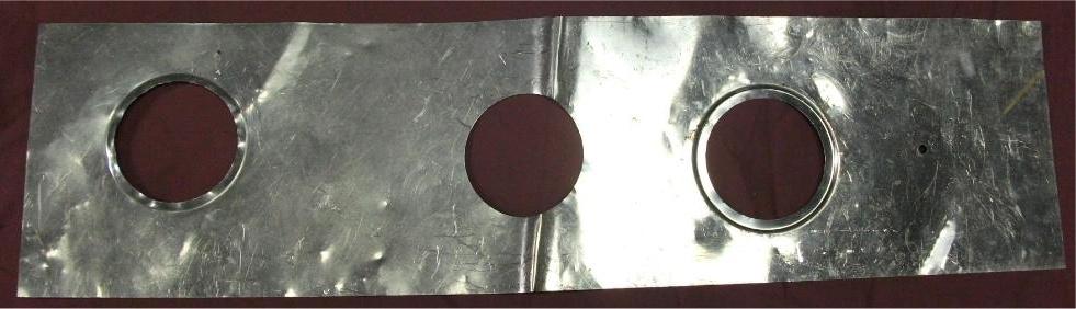

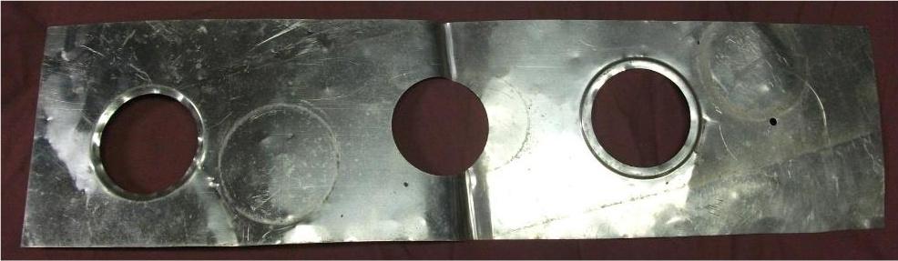

    Meanwhile, this old scrap bit of aluminum was found that was used when I was testing the SBD dive brake hole punching and forming tools that I was making. (Tools ended up I don't know where, sadly- the owner died some time ago.)

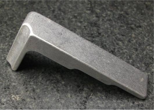

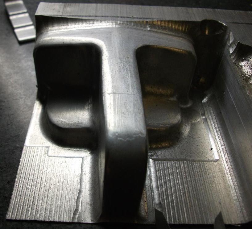

    Also found some P40 brackets that are still "in process":
    (Copied off an original forging- It just doesn't look the same when merely programmed into a CNC.-It's an "analog" part. Plus, I "upsized" it about 10% where possible to compensate for the lack of the originals' forged grain structure- It also is of stronger 7075 aluminum which we shotpeened as well- to help life in a high vibration enviroment. )

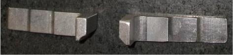

    Made a blue million of these little Curtiss bits, too, many using a 24" universal shaper, which was kinda slow for larger runs:
    Four thumbs up "smilies" if you can specify where the above parts go!
    If you have "straight" original parts- even corroded, you can build new, using the old as patterns. But wing and fuselage jigs need to be made before the last airframe of whatever type becomes "bent", destroyed or otherwise unaccessible. Drawings just won't get you where you need to go.
