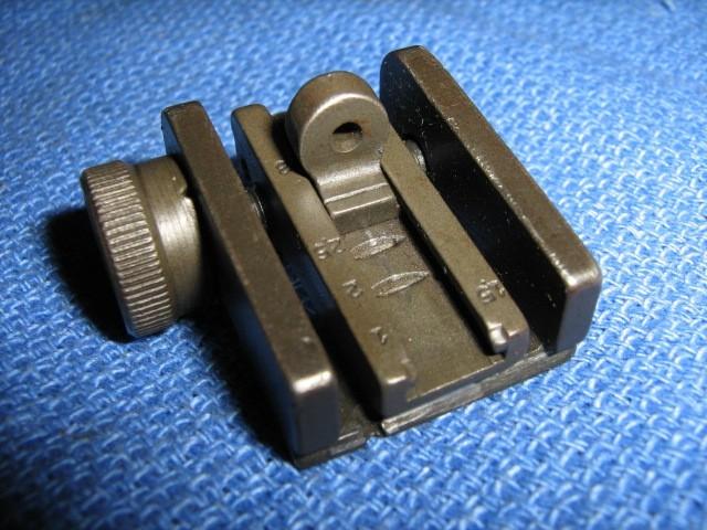

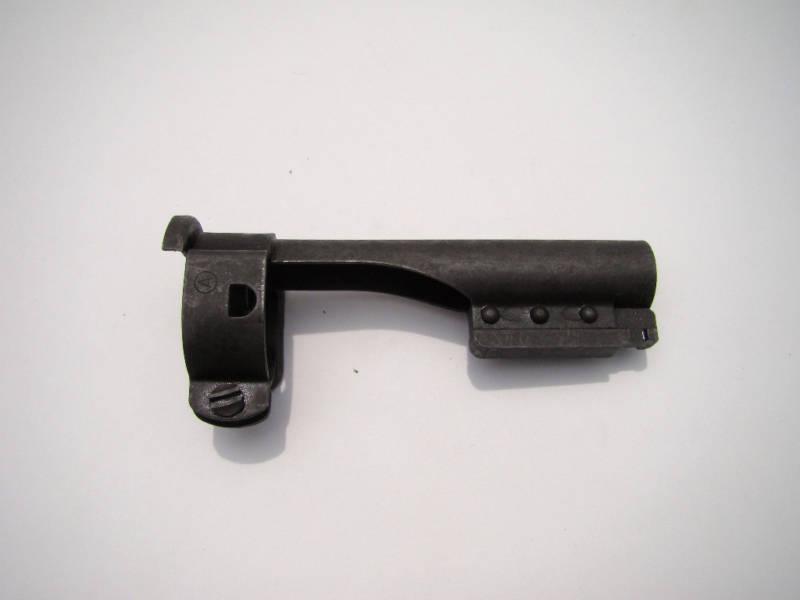

    If so it might have the arsenal updated bayonet lug type 3 band, first picture. In that case an adj sight would be OK. They are about $25-$30. Second picture. This is still a US GI part. Just used in later production and added during arsenal updated. You can ask here on the WTB listing or look on line for one. Should be pretty easy to find.

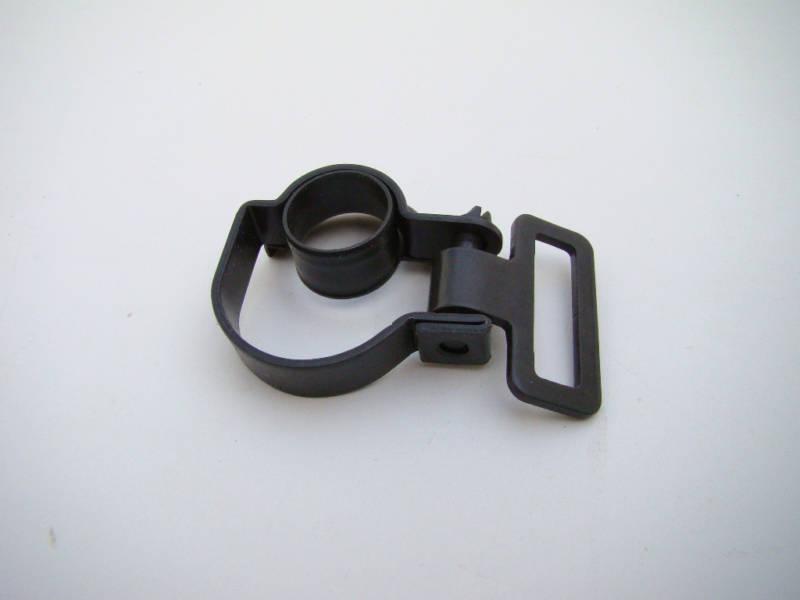

    Your carbine originally had a thin type 1 front barrel band, third picture is of a repo band but is the same style. Then it would take a leaf sight with a square S on the base. They cost about $125-$175. Fourth picture is for a Rock-Ola not a Winchester but is the same style. You could put a WTB listing here, but this will take some hunting. It is also highly sought after by collectors.

    Type 3 barrel band and adj rear sight
    Repo type 1 barrel band and leaf rear sight
