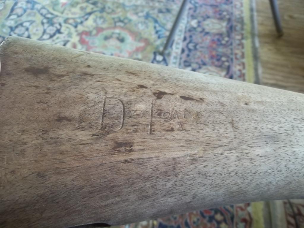

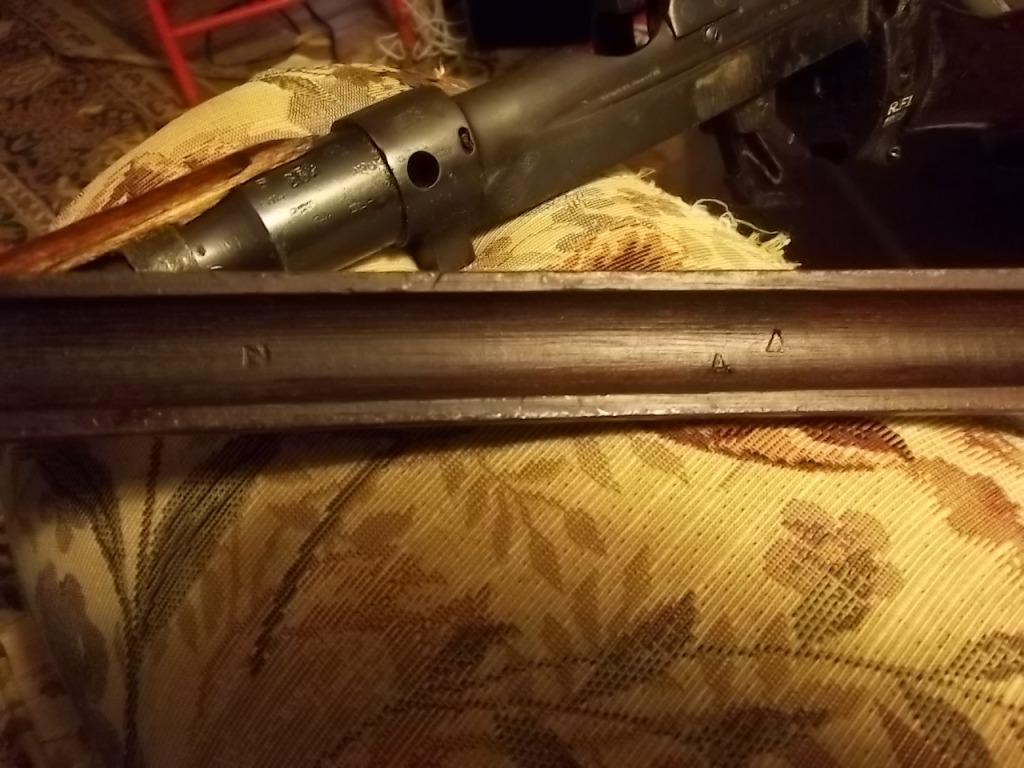

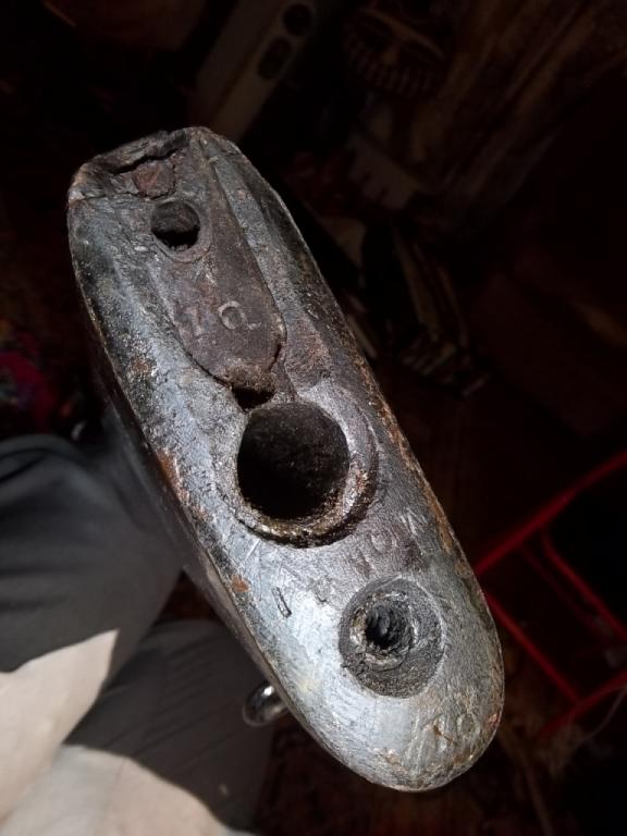

    However, I am going to take "her" down and clean up the metal and check for rust and rot. As mentioned, I am a firm believe in documenting what you find! I do know that many people do not document... and seem to hoard knowledge!
    Here is what I have so far to share!
    Upper handguard with assorted marks.
    Here is the butt end of the stock! There are a set of numbers...
    Now the serial number of the non- rifle is 6500U. As can be seen, the barrel matches the receiver... but the receiver has also had a set of number "x'd" out. It appears to be the same number.... so why it was "x'd" out is a mystery to me!
