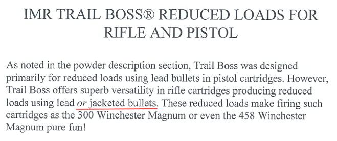

    Trail Boss says in all their documentation for lead bullets only. So far I have used it in my 1917, I have 3 #4's and a #5 and the #5 is a beast for kick, I may try working up a load with trail boss for it.

    Quote Originally Posted by Ben Cartwright View Post
    Horsefeathers! Here's the opening of IMR's document on the subject. See http://www.imrpowder.com/PDF/Trail-Boss-data.pdf for the full publication.

    Well, that's easy enough! Oddly, having printed out Trail Boss loading data two or three times previously, this is the first time I've seen that notice. Most useful info, Parashooter!
    (DO refer to Parashooter's link above - that's where the tasty bits are hiding.)

    I stand corrected, I thought I had read lead only.
