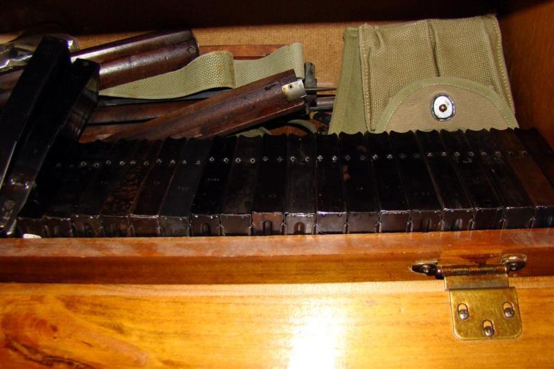

    Hopefully someone here has some extras. I'd put a WTB up. It wouldn't hurt anything. I feel bad I don't have any left for you -
    They had just been sitting there for years and John made a good offer for all of my extras and I had a big Dr bill to pay .

    Wow! It looks like you had a nice stash going. Sorry to hear it had to go away to cover expenses. That's never fun.
