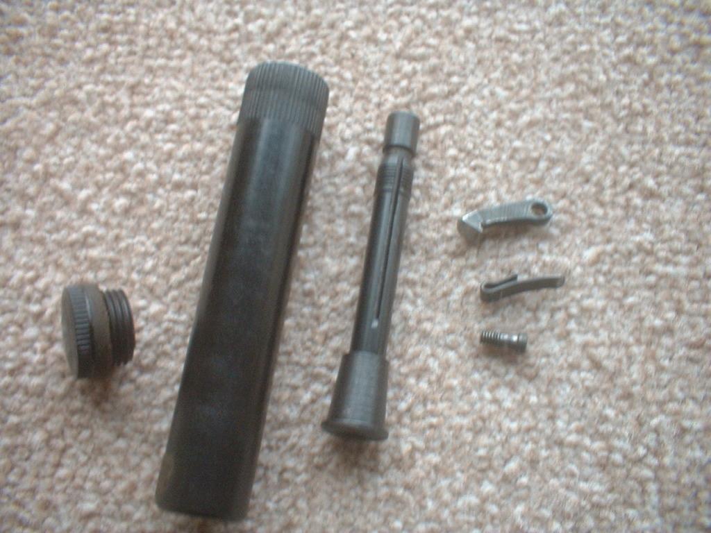

    ALL reloaders of the .303 Britishicon cartridge should buy a military broken case extractor and have it handy in their tool box. They make a hard job easy and will not damage the chamber extracting the front part of the case.
    You dont need to keep one in your toolbox - keep it in your Butt along with an extractor, extractor spring and extractor screw - they all fit into an oiler bottle.

    Hey Alan, you just gave me a great idea for what to do with the many plastic oil bottles i have here that have a broken spoon. Lee-Enfield survival kits!! Brian
