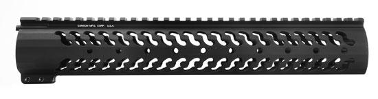

    If you want a simple, light free-float fore-end consider something like the Troy TRX Extreme or the Samson Evolution. They come with accessory rails that you can mount wherever you require on the sides and bottom. Both attach to the factory barrel nut.
    The downside to these two are that you need to remove or cut down the front sight base in order to install them. If I had a rifle length upper with a pinned front sight base I'd just cut the FSB down and remove the delta ring and front handguard thingy with a Dremel. I've done that on a buddy's LMT.
    There are also two piece FF fore-ends like the Troy MRF that will install without removing the FSB. You'll still have to cut off the delta ring and the handguard thingy, though.
    I have a 11" Samson on my Armalite carbine and it's quite light, without all the extra, unused rails that a quad rail would have. It covers my cut-down, pinned FSB.
