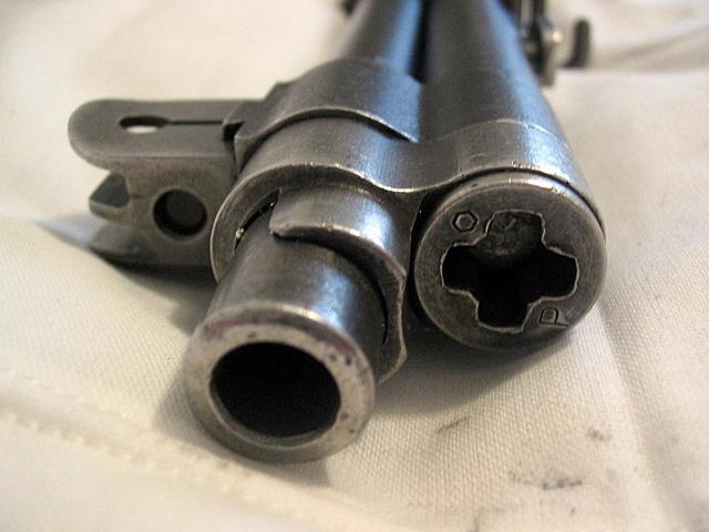

    My first M1 Garand I bought few months ago is WWII (Jun 1944)
    Here are some pictures :
    Serial Number 2,827,xxx
    Barrel 1-SA 6 44
    Stock SA GAW
    Receiver D 28291 32
    OpRod D35382 3 SA
    Bolt D28287-12 SA S-B 7
    Trigger Group D28290-14
    Trigger C46025-1 SA
    Hammer C5546008
    Salu2 a to2
    Bizio
