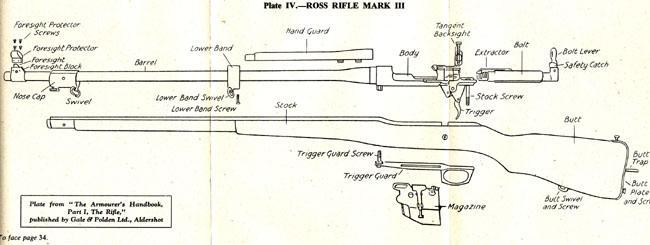

Sorry guys no new her, I like the I already have to much. Thanks for the ID help. I would like to see if it shoots, I know it hasn't been shot in at least forty years and I venture to guess its more like sixty. Is there a schematic of this rifle some where?
Tnaks again.
Aaron
First of all, the Illustrations are for the M-10 (1910) Ross Mark III and do not really relate to the OPs 1905 Ross Mark II a whole lot.

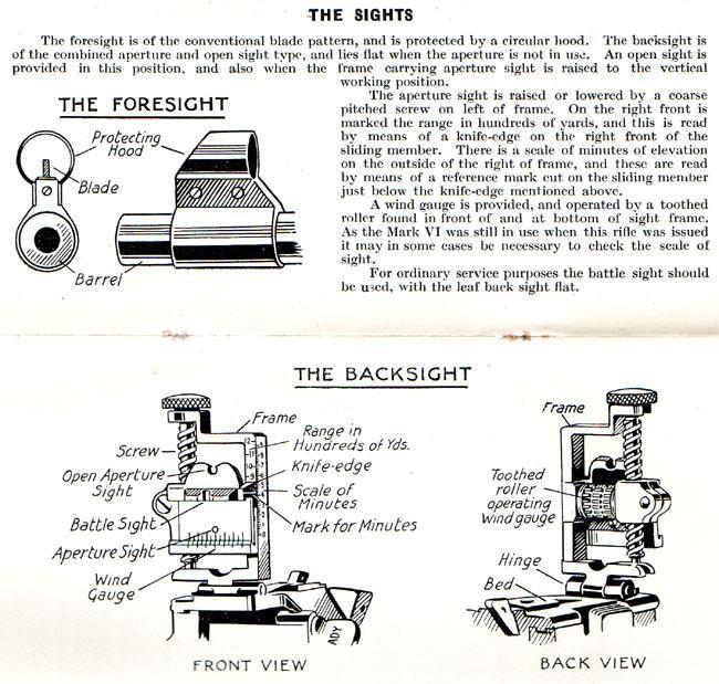

Originally Posted by
zuke
If you look at the drawing of the backsight, and read the text, you will find that the BATTLE SIGHT is for General use out to about 300 yards.
The open Aperture sight is read on the VISIBLE FRONT OF THE SIGHT WHEN VIEWED using the KNIFE EDGE and the scale on the right hand side.
The PEEP Aperture sight is used for the range in MINUTES and uses the Reference Mark just below the knife edge on the right side of it.
Windage is adjusted by the Toothed Roller to move the PEEP Aperture sight left or right.
