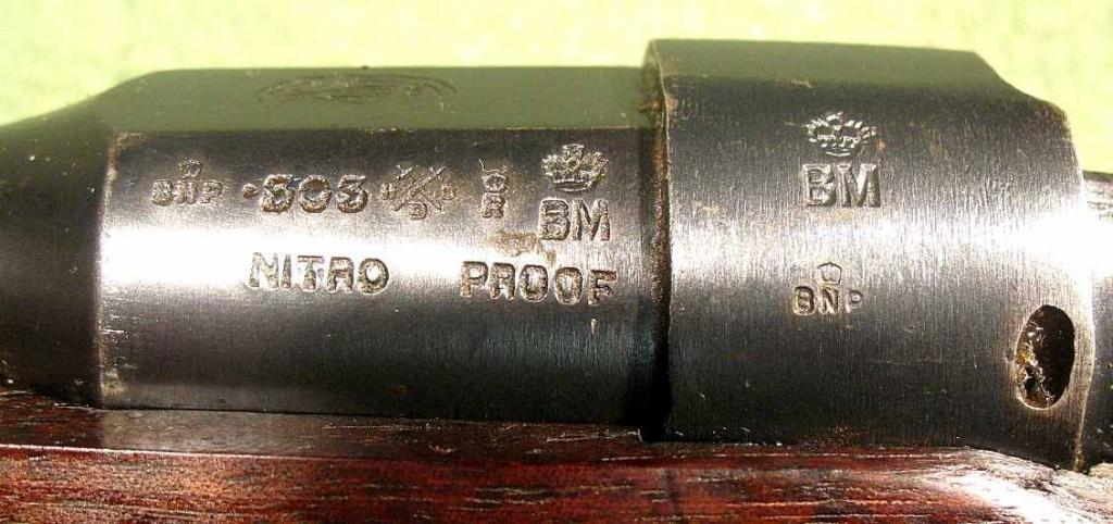

    This is the "Bahrain BSA" I have currently.
    The "BNP" on the receiver ring and the bolthead are the "new" Birmingham proof applied since these rifles came back a few years ago. All of the rest of the marks, including the "BNP" on the barrel, appear to be original.

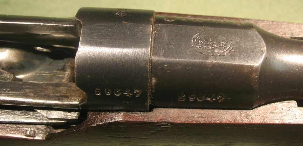

    Bolts have matching numbers (well, they did have once....) in same font and strike as the receiver. Bolt also has BSA commercial mark:
