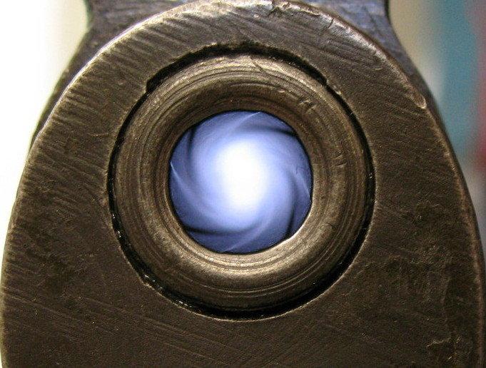

    I've reviewed all the posts and find them very intersting and helpful. Part of the interest is to achieve a better understanding of the craftsmanship skills that have been applied in the development and manufacture of these superb rifles. Any rebarrelled guns will be restored commensurate to the value of a new rifle. They will not just be "shooters." Besides they will have a 4-groove rather than a 2-groove barrel, making them somewhat different than the average rifle available "as new." Yes, I know that this may not make any difference whatsoever in their final accuracy.

    4 groove rather than a 2 OR a 5 OR 6 groove barrel

    4 Groove already done as well!:
