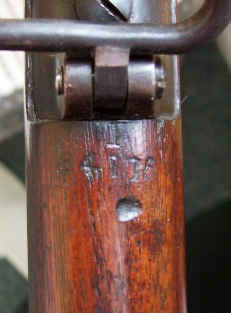

    at the wrist underneath on the stock. I bet it's the original stock. And they rebuilt it with a 1953 reciever. It would make sense.
    ---------- Post added at 09:48 PM ---------- Previous post was at 09:44 PM ----------
    it is a 43

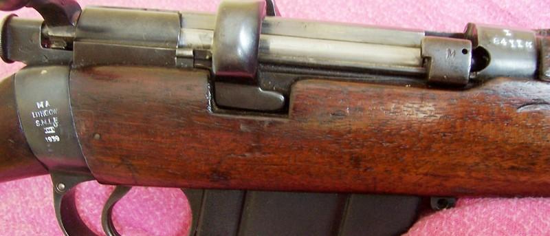

    Apparently they did Peter but I've only seen one example of it. A 1918 EFD body been replaced with a 1939 Lithgowicon action. The owner is a member here and I'm sure he would post it. I doubt it would have been commonly done and hard to understand why they would at all.
    In the case of the rifle on this thread, I would think it highly unlikely they would have rebuilt an earlier rifle with a 1953 dated action. The 1953 rifles were purpose built to test the machinery and labor force (Ian Skennertons words). The serial number would confirm. They range from F39581 to F40580 from memory, I hope that's right.
    An earlier butt could have been put on the gun at anytime after it's manufacture.
    I suppose never say never in Enfield world but that would be my take.

    Not sure if this is what you're on about but......
    I have a 1918 SSA that was ftr'd at Lithgowicon in 1951. Everything bar the receiver was replaced.
    Timber, barrel, nose cap, bolt, and magazine are all BA or MA 51 marked and Seriel numbers all matched to the original SSA one.

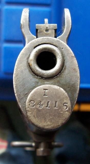

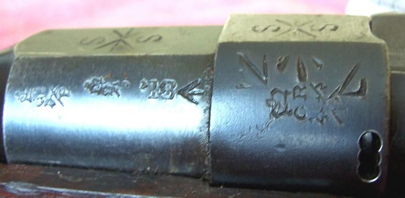

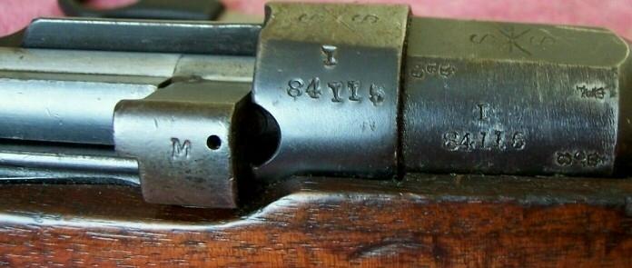

    The only thing on this rifle that is 1918 is the barrel. probably rebarreled with an early barrel by persons unknown and the serial number stamped on.
    Note the finish of the knox on the right hand side in relation to the left, and the very faint marks above and behind the S/N.
    When you compare the S/N on the Receiver with the one on the Barrel under magnification, they were not done with the same stamp.

    Quote Originally Posted by muffett.2008 View Post
    So what are you suggesting Muffer?
