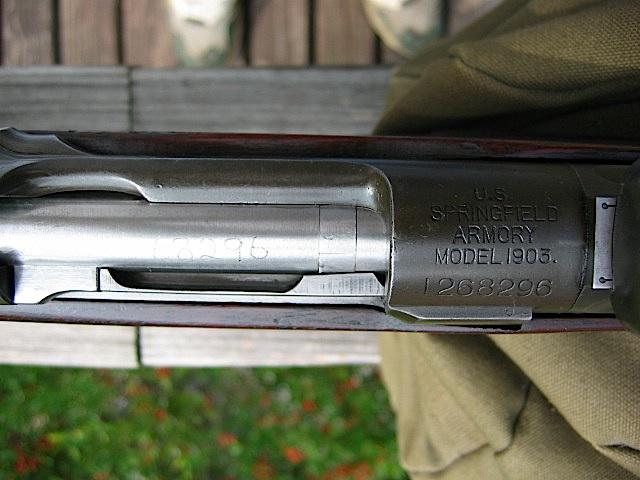

    pics
    Pics are in my gallery now. Let me know if others are needed and I'll put them in the gallery, if that's ok.

    The star gage mark on the muzzle looks original, but the serial number on the bolt does not. Also, during that period only the last five digits of the serial number were on the bolt.

    Would there not be proof marks on the barrel, or stock after the rifle had been rebuilt? Also, was there nothing on the rifle saying it was a NM rifle? I was also noting the fonts of the numerals on your bolt, and mine. The 2, and 6 do look very similar. Are there any other pics that would be helpful, sorry for the poor quality of my pics. Thanks for the pic, and help.
