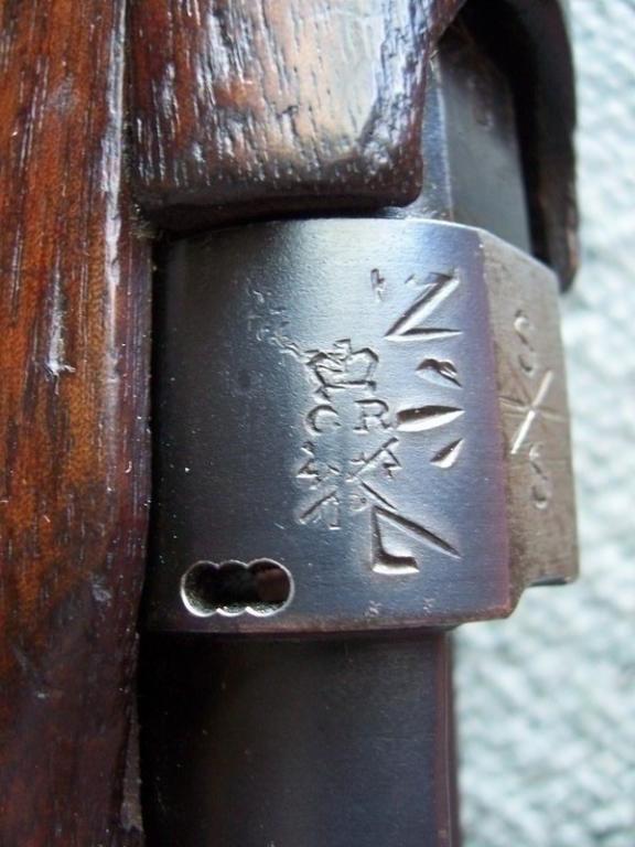

    Well 5th Batt beleives it to be genuine, I concurr, and Ian Skennertonicon believes it to genuine, to the extent of mentioning it in his latest book (look it up if you care to) While 5th Batt and I might not know everything about Lee rifles, we have seen in our years of collecting over a thousand of them and I personaly have catalogued hundreds of them for New Zealands largest annual auction of militaria. If you don't believe 5th Batt and I, can you at least believe Ian? He's the man who should really know.

    If that is part of an L over crossed flags, I believe it to be a Lithgowicon proof. Hard to say for sure but it looks like it to me.

    Quote Originally Posted by muffett.2008 View Post
    This appears to be a MkIII.
    What on earth makes you think this is a MkIII & not a MkIII*?
    Yep, not too clear in the photo, will try to get a clearer one up tonite.[COLOR="black"]

    Here's another photo of the proof stamp, there is an indent running though it, so only the toe of the L is visible, part of the P is also missing but definitely a Lithgowicon proof stamp.

    No, you didn't send me scurrying under a rock, But I did spend a day going through my collection to check proof marks. As I new I had a BRIT/LITHGOW proofmarked rifle, I just had to locate it, not so easy in large collections.
    So several rifles drew my attention for closer inspection, a trusty old laptop, camera and a hand electronic microscope and I have a result.
    Skennertonicon calls this rifle and one other occasional discrepancies, hence the need to make comment about them, and annomalies they are.
    Below is a montage of proofs, the first is your rifle, the overlay is of one of mine enhanced with a digital microscope, the remainder are slight variations of Britishicon Proofs.
    As I did not have your firearm at hand, I did not attempt to scale your proof as an overlay, but I did with the ones of mine.
    The measurements if you are interested in checking, are: Brit/Lithgow barrel=3/8HX3/16W.
    Receiver=5/16HX1/4W, Brit proofs 3/8HX1/4W, Lithgow proof 5/16HX1/4W
    Attachment 31944 [ATTACH=CONFIG]31945[/ATTACH
    There are similarities, therefore the benefit of doubt is in your favour, however, I still think this proof, if correct, was applied in Britain, the same period Australianicon proof shows a different L and the late lithgow proofs did away with the crown.
    As I stated in my post 57, there are no certainties this far down the track, Skennerton looked at 2 firearms that were not the norm, there are probably thousands out there that do not fit our idea of normal, that is the great part about collecting, finding that odd one and attempting to trace the reasons for the variation, even if it raises conflict.

    I'm not sure I'm following. Is it an L in the proof in question? If so doesn't that make it lithgow. You'll find this same proof on lithgow actions but with slightly different font ranging over 20 years up to 1941. What Australianicon proof from the same period are you comparing that has a different font L? Is it the rifle with 1927 dated barrel in your photo's? That would be understandable given the many years between actions.
    The crown is present on late lithgow production as far as I'm aware. Perhaps you mean the royal cypher is not.
    These are 1940 and 41 lithgow actions. The style of the L looks very much to be the same as the OP's rifle to me.

    There are so many different way's and reasons it could have happened, really everyone of them is a guess. I don't understand at all why they would be placing parts from an old rifle on a brand new one at the factory to build to sell to NZicon. Maybe there is a batch of them because they ran out of receivers????? I wouldn't have even found it to be odd if it had been done in later in the war in the field by a division Armour as they had stamps and would have renumbered it to the rifle as well.
    The crown is present on very late model no1 MK3* Lithgows
