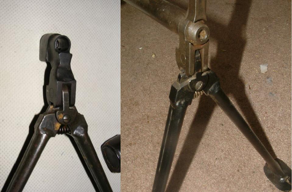

    Thanks for the picture of the bipod Warren.
    The bipod legs are from the 1950's Czechicon made UKicon Vz59 Universal MG !
    Have you any more pics that show a side view to see if the legs have a swage running up the leg ?
    I will post some pics in a bit for comparison.
    ATB KG

    Will try and do a better pic later (flash hider has been removed for clarity) when the sun comes up a bit but I think they are one of the same with a modified head ?
    The bipod feet in the original pic also show them central to the legs the same as the Vz59.
    ATB KG

    Hey guy I think you nailed it!!!
    I'll pass this on to the owner. He will be thrilled. Sort of helps my theory it was not original to the rifle or even the period they had hoped. I know that our friends at WWA made up some years ago, but I think he used Bren bipods. Do you have the DDE number on it by the way? I have a copy of the DDE here somewhere but don't have the time to look in 2000 files, plus I still have over 5000 plates on microfilm to read on the Bren alone.
    I'll contact the owner and try to get some more photo's as the ones I got originally were horrible and I forwarded this last one without even looking closely at it. I'll send you what else I have in photo' on this thing via personal email, but I think you nailed it.

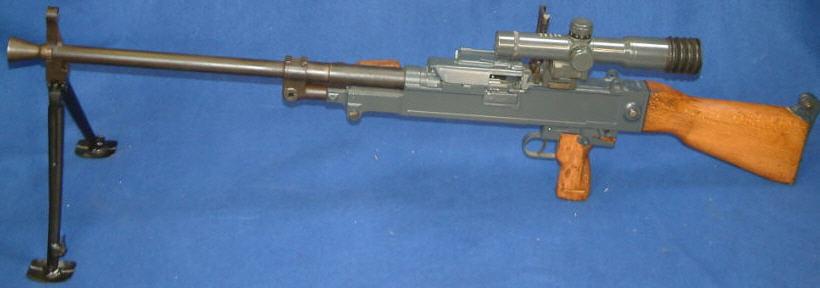

    Just for reference a picture of the Vz59 MG the bipod on the 4T looks to have been gleaned from.
    ATB KG
