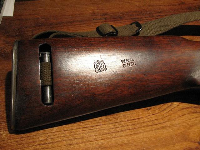

    This is on an an original 5.6
    Made March 1944, low wood, uncut, no W in slingwell.

    WB lists the type three stock as starting after March 1944 with only the crossed cannon stamp. WB lists the type 4 stock as late production but no time frame. Riesch lists it as 7.2 million but I think it may have been earlier then that. Maybe in the 6 million range.
