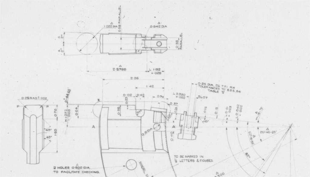

    I never had the forming tool part and I am guessing thats not uncommon so does any one want me to put up the drawing for that, which is within the realms of a lot of the good folks here?
    Until just now I didnt realise that D.D.(E) 2319 wasnt the first proposed version and there was D.D.(E). 2253 from 15th June 1939. It didnt last long as the others dated the 30th of the same month.

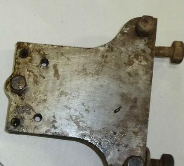

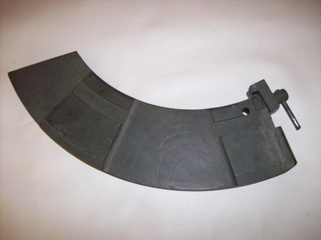

    Does the other half look like this?
    or this

    The lower one. On the D.D.(E). As well as the dimensions it specifies the metal, heat treatment and tolerances, I don't know why there seams to be far more of the mandrels than the tools out there.
    ATB
    Tom
