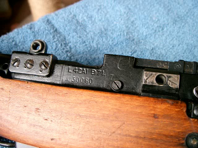

    No.78 was also used on the Wombat...They are not too difficult to put back into No.32 configuration.

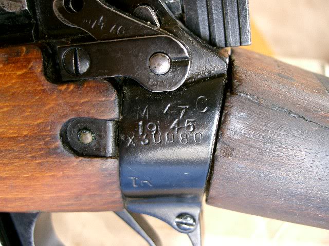

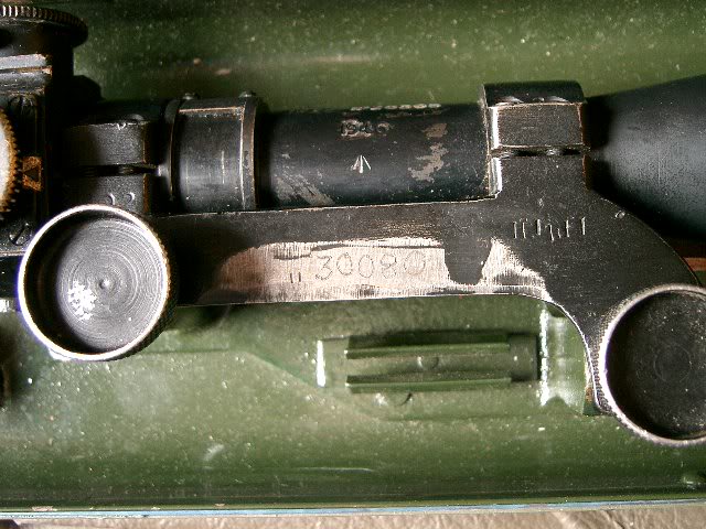

    Here are pics that might help.

    That's interesting Wheaty and Gunfish. Some Armourers at Field and Base workshops used to put the rifle serial number on the side of the backsight if it had to be removed so that it'd go back on the same rifle. It looks like this has been done on yours Gunny. See top picture (but it's the wrong number!)
    Wheaty...., do you mean change the No78 sight grat pattern to No32?

    Gunfish,
    Rifle X30080 was part of a batch of 18 rifles and the conversion process was completed on the 4th june 1971, from there you rifle was despatched to store at Donnington.
