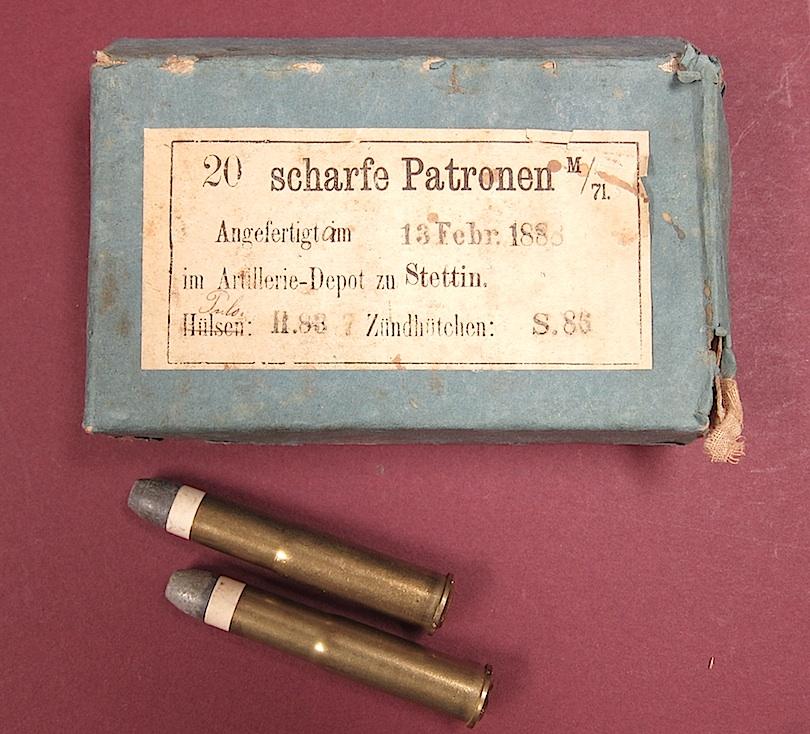

    When our group was shooting the 71/84 rifles, we were shooting original ammo. Try as we might we never came close to the accuracy of the original paper patch ammo, but we tried to develop a smokeless load.
    Tracked down an old friend I hadn't seen in probably 30 years, and in the course of conversation he mentioned that he had gotten off deep into black powder shooting, making regular trips to Raton, New Mexico. He said he never realized the rifle's full potential until he had a paper patch mold made for each rifle, and made his own bullets.
    This is some of the original ammo, and in beautiful condition to be almost 125 years old. We shot up something over 1000 rounds, and never had a misfire. We also shot the .43 Spanish, and you could count on at least 50% fail to fire from it.

    I would have thought that those original boxes look much too valuable to shoot...
    I tried paper wrapping the bullets but without much success.
