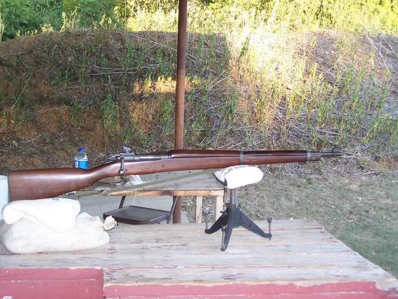

    Scant grip stocks have can have a certain charm when a fellow is 18. This was my first ever center fire rifle, purchased from a pawn shop in 1975. First two deer were taken with it. First few years of high-power competition were accomplished with it. It's a early Smith Corona with a six-groove barrel dated 12-42.
