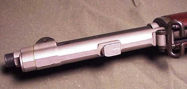

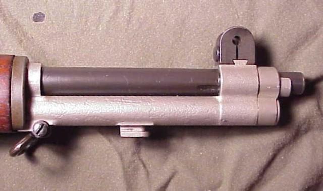

    Jim, another thing is I think we are talking two different things here. Polished gas cylinder vs unfinished gas cylinder. The initial description suggests unfinished. Jim, the LL you posted suggests worn finish. I am curious about Tom's and would like to see some detailed photos of the gas cylinder and whether it is unfinished, worn finish, polished or maybe as was said earlier some other finish like dull aluminum or silver paint.
    This is a great thread guys! I would like to hear more of Mr Seijasicon' opinion on this too.

    The gas cylinder photos linked by Mr Seijasicon shows it is difficult to tell if it is dull aluminum or silver paint or if there is no finish on it at all. If the latter, I would say it is unfinished and never was finished.

    See, your worn cylinder is very different from the white ones -- the whites don't look like bare metal to me, too white (not at all silvery) and too uniform. Also matte, not shiney. There's a coating on there IMO.

    OK, so here's the pics of Tom Gray I think I scored a Lend Lease Garand!! His Gas cylinder lock screw shows finish and so does the back of the sight base at the bottom. I agree Bob, the one that's all clean looks like something devoid of blue or park. And matt finish. Not worn like mine and Tom's.

    It is hard to say but Tom's looks devoid of any finish also.
