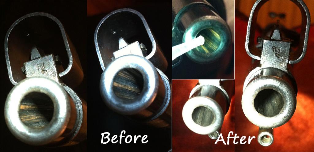

    Use the foaming bore cleaner let it sit for an hour then run a round patch with a 8mm jag then repeat several times.All of the blue color that comes out is copper fouling.
    I used to use Hoppes and a brush but I find the foam to be more effective and I don't have to worry about possible damage from the brush.

    Hoppes No. 9 will remove copper wash. Just swab up the bore with a dripping wet patch and let it set overnight. Watch out for ammonia based solvents, you do not use them overnight.

    Thanks guys. Gunslick foam bore cleaner did a good job. I let it sit in the bore for 50~60 minutes and the blue liquid came out. After cleaning the bore, the copper fouling was gone.
