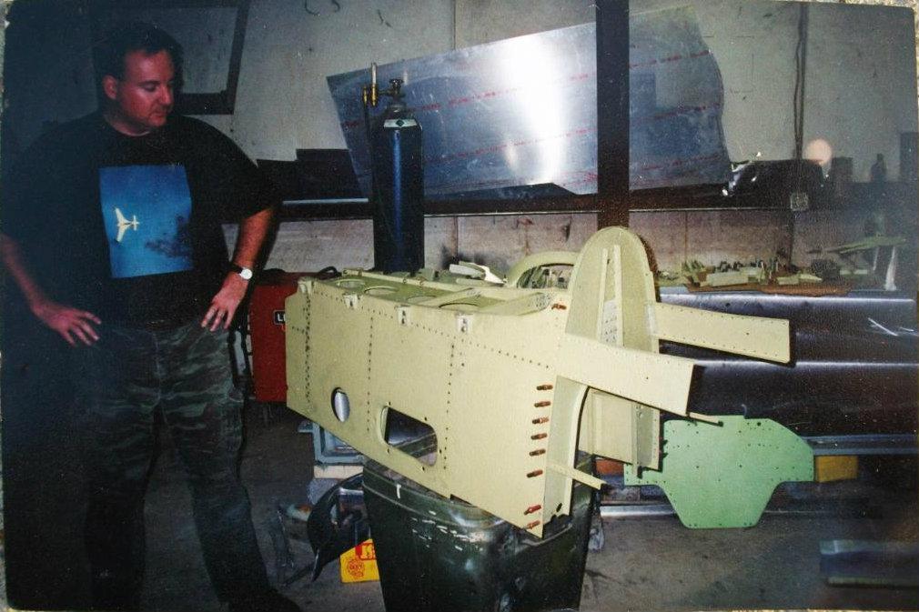

    Found these pictures whilst moving stuff about the reloading room.
    (See this thread for the mess: Aieeee!!! This is progress? )
    Just a few reminders of the madness back in the late '90s. This P40 late won the Phoenix award at Oshkosh. I reckon it's still flying. Everything you see on the fuselage tail subassembly was made new. The firewall was also all new except for the engine mounts and the plumbing pass through plate. I primarily made attach fittings and tooling, but I also got into some of the sheet metal forming and riveting.
    Just noticed that there's two tail subassemblies in this photo! And a chunk of old forward upper fuselage in the right background sitting on a couple of stools. Lower firewall is on left foreground and the upper dominates the right foreground. Upper fuselage jig in back of the firewall jigs.
    John Hassard looking at the "just pulled out of the assembly jig" fuselage tail subassembly.
    The armor plate on the floor was original.

    Are these P-40's your speciality JM? Did you see that one was found almost intact in the Egyptian desert recently.
    Restoration of these things fascinate me. Brilliant work. Will you explain the mechanics of those copper un-rivetted sort of pop-rivets that seem to be in the tail part. Have often seen then but......

    Peter, I know I'm not JMoore so I hope I am not stepping on anyone’s toes with this answer. I will venture a guess that you are referring to the nine (that I can see) "Cleco" fasteners that are installed in the tail in the last picture. Clecos are a temporary way to hold pieces of sheet metal (and other things) together. They come in a number of sizes and are generally installed and removed with a special tool that looks like a funny pair of pliers. This link is pretty basic but the pictures in it show what I'm talking about more quickly and concisely than I could type it up to explain it: Cleco pins - how to use ? - MIG Welding Forum

    We also used a non-spring loaded version that is slower to use but has wedging action built in. The downside to the "English pins" (that's where we bought them) is that they were anywhere from US$3 to US$6 apiece.! We had 2-300 between two of use. But Clecos we had by the bucketful! When I find more photos I will post them if anyone is interested.
