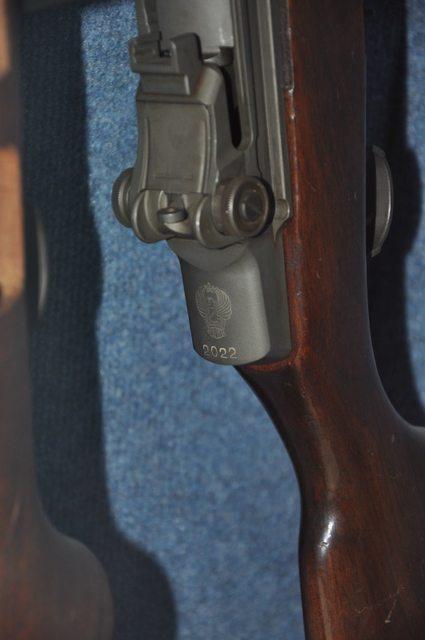

    It seems when Italyicon adopted the NATO standard cartridge, rifles that were in stores were returned for conversion. New (shortened and rechambered) barrels, 1/2-inch shortened op rods (marked 7.62-2) and production stocks/handguards were installed. The receiver banner stamps were also modified by removing the "CAL.30" reference and "7.62-2" stamped on the ledge just aft of the rear sight base.
    Few military rifles have surfaced but I've noticed that the font and markings of the 'earlier' banner stamp is slightly different. The one in the middle still includes "US RIFLE" with what can be assumed to be "CAL 30 M1icon" under it. The other ones show no signs of ever having "US RIFLE" roll stamped. It is conjecture on my part, but maybe different production timeframes saw different banners?
