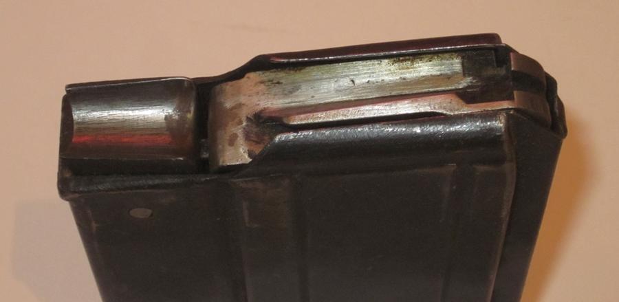

    Hmm...I have a parts kit of one of the Chinese converted Brens that I'm sending out to have built in a couple months. I've talked to folks with functional Type 99 Nambus and ZB-26s in 7.62x39, and I was hoping the Bren would be do-able as well. I guess I'll find out! I even managed to find a ZB-26 magazine converted to feed 7.62x39, in place of the more common AK mag conversion:
    Unusual Chinese ZB/Bren Magazine

    ForgottenWeapons,thanks for the post about your mag and the link to the other pictures.....very interesting.
    What are the markings on the spine of the mag ?
    Are there any markings on the conversion parts ?
    Have your tried any 7.62 x 39 rounds in it ? ......just wondering also if 7.92 x 57 crimped blanks would also fit ?
    With this setup the rounds are further back than the AK mag conversion so the small 7.62 x 39 rounds vent off gas is going to have to work overtime to push the working parts back that extra inch to cycle the next round or to capture and hold the piston extension.....plus another inch of friction :-)
    Good luck with your conversion and let us know how it goes.
    ATB Kevin

    I don't recall the markings on the conversion parts, and they're a bit packed away right now. The magazine (which I found separately) is numbered "186" under the front lug and has what appears to be a small stamp of three interlocking diamonds on the spine (no Germanicon markings).
    I have tried x39 rounds in it, and the feed lips are a bit loose but the length is perfect. It'll hold about 15 rounds before they start to act up because there isn't any curvature to the magazine. I would be surprised if it will feed reliably with more than 10 or 12, though. Guess the only way to find out for sure is to get the gun built!
    I really want to find an 8mm Bren barrel to go with the kit, so I can shoot either cartridge.
