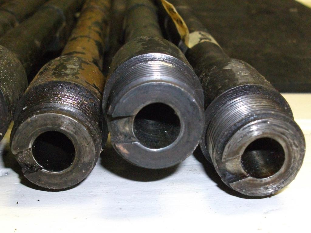

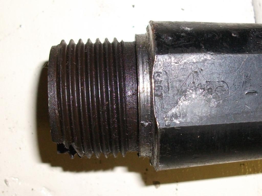

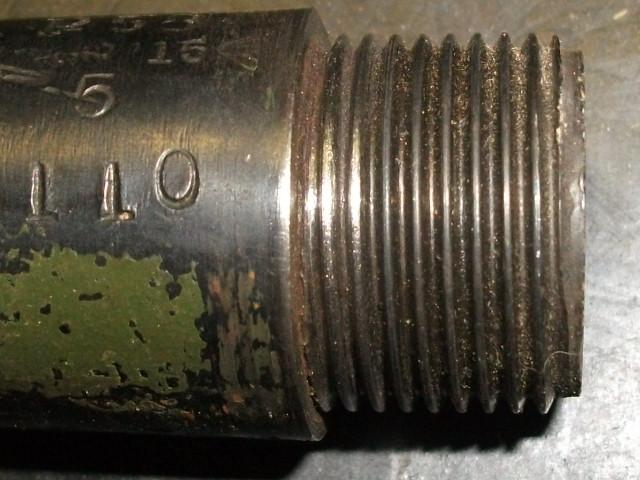

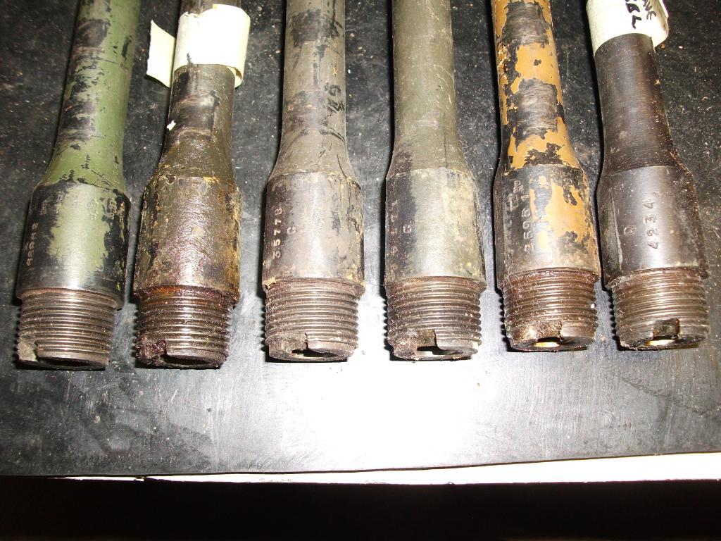

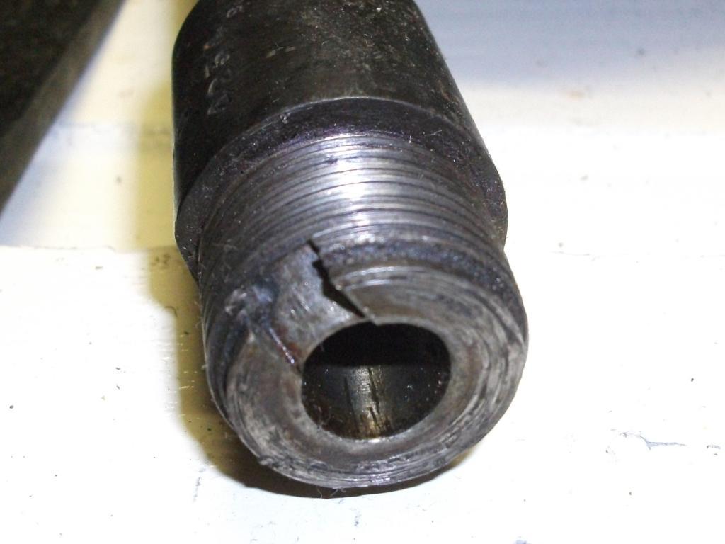

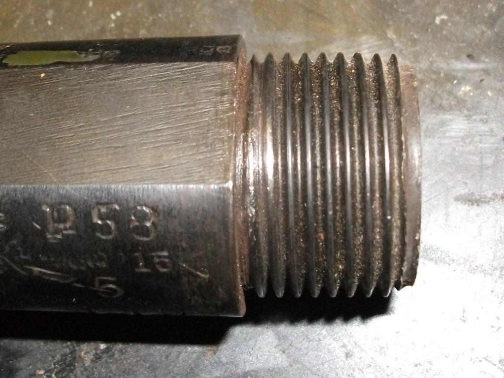

    Found some pull offs. (Found more after taking these photos.)
    The significant feature is the lack of a thread relief at the front face junction. Quite mad actually! All of the load (90% or so) is taken by three-four threads. So, losing a thread or two here would mean nothing! Having to run threads to a hard stop means that the cutter was quite fragile. Even if some sort of die was used. So it would be quite easy to have an oversize condition in an area that's hard to measure. Which could easily cause the barrel to stop rotating early. The natural reaction would be to remove metal from the rear face. It's where contact is supposed to occur, after all. Trim off a bit and try again. And so on. If cutting the rear face didn't work, the next most likely step taken by a hurried factory fitter would be the front face. Redoing the thread? Out of the question for that particular machine operator.
    But it seemed to work in these instances anyway. The ones that loosened prematurely were rebarreled long ago. The "thread lock only" works partly because not much force is required to secure a barrel for shooting purposes. Just ask the benchrest crowd. It was helped by the fact that the No.1 had the bayonet attachment separate from the barrel, so no external torque loads would be applied except during front sight adjustments.
    This barrel pictured above and below is one that made both front and rear face contact, BTW.
    But even when rear face contact is made, too much can be bad. Here's a badly galled example:
    Here's a scrap No.4 barrel that shows a much better threading design with a nice relief cut that makes both threading and setting the front face dimension easier . (Disregard the extra step cut into the shoulder during removal.):
    Muffet.2008 might be able to 'splain all this better. (He already knew the drama.) Or any number of our fine mob...

    I don't think I need to JM, your pic's show it all, but to add a simple explanation for the uninitiated, by cutting a thread relief (removing the last two threads near a shoulder) allows the component to be locked up against a face with no binding of the threads, or step cutting (cutting a relief in the female face) to achieve the same thing.
    This relief or undercut assists the machinist when thread cutting also, it would appear by those pics that the barrels were actually threaded on a die rather than a lathe, I guess that would certainly speed up production, it may also explain the misaligned thread on the third barrel from the left, or is it just my eyes?
    Thanks JM, that's a great result and certainly brings the answers to the original posters question
