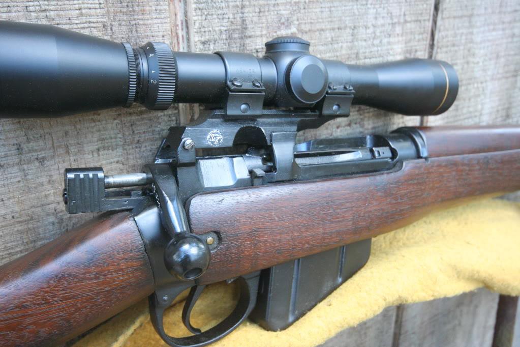

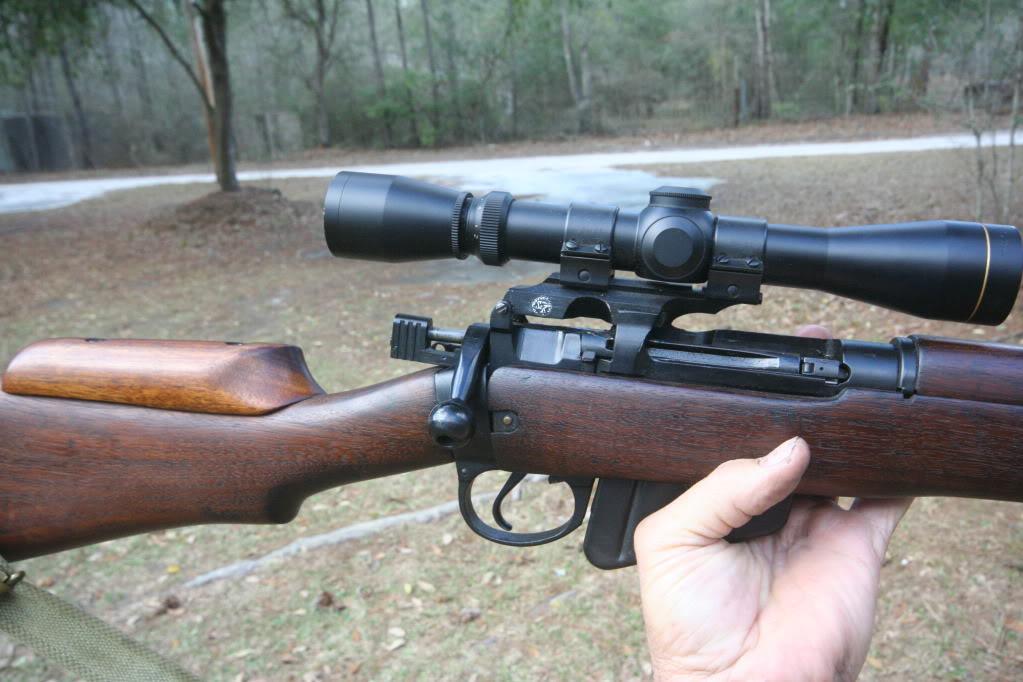

    strip the gun, prepare a tub of steaming hot water and dump in oxi-clean scrub the wood with a firm brush. let it dry out for a day then put it in the oven on warm, all the oil will be removed and the wood will turn to it's original color. here is mine i did and reoiled.

    Nice results.
