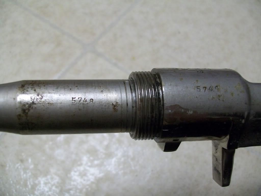

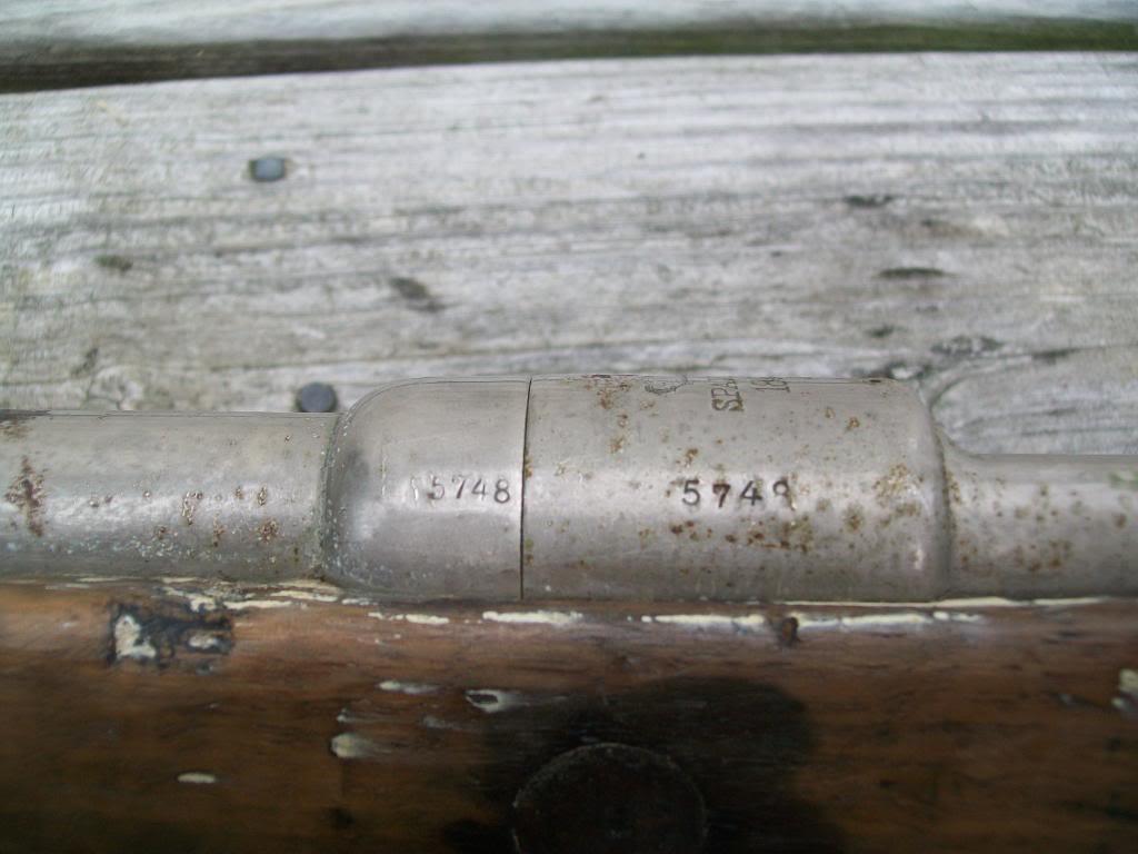

    The barrel, shroud and receiver are match. Bolt trigger guard are not!

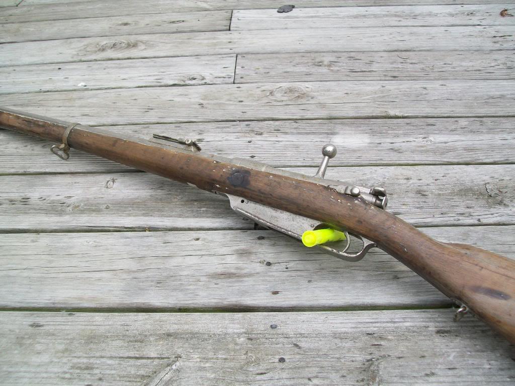

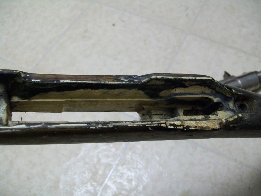

    It appears that it was slathered in white paint on all the wood at one time. There is a question on how "original" this is...

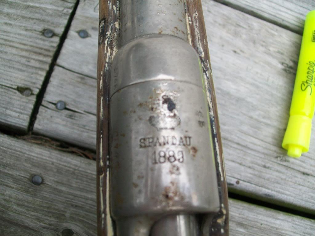

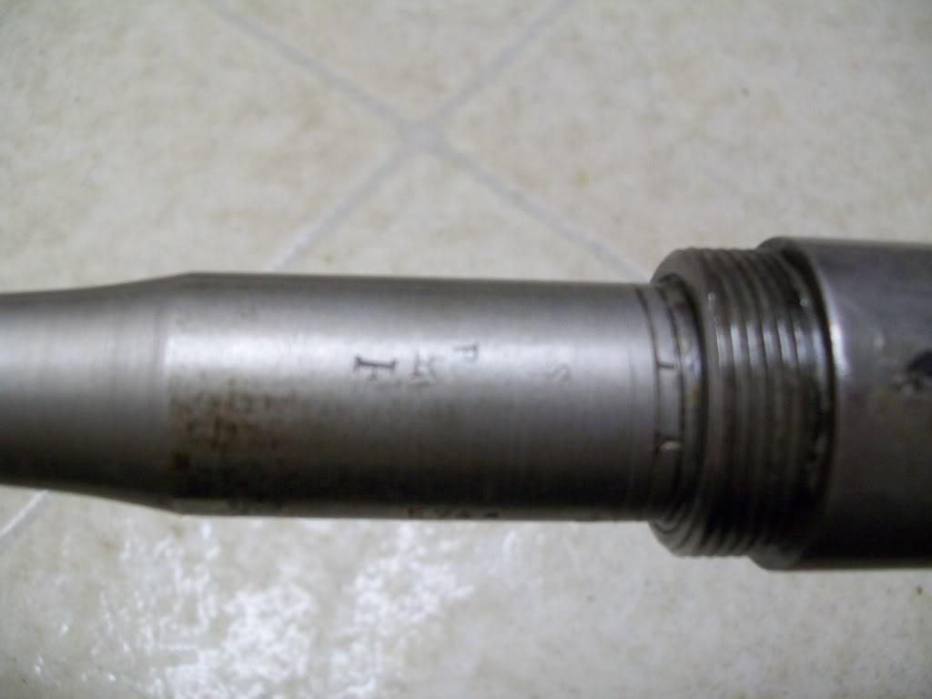

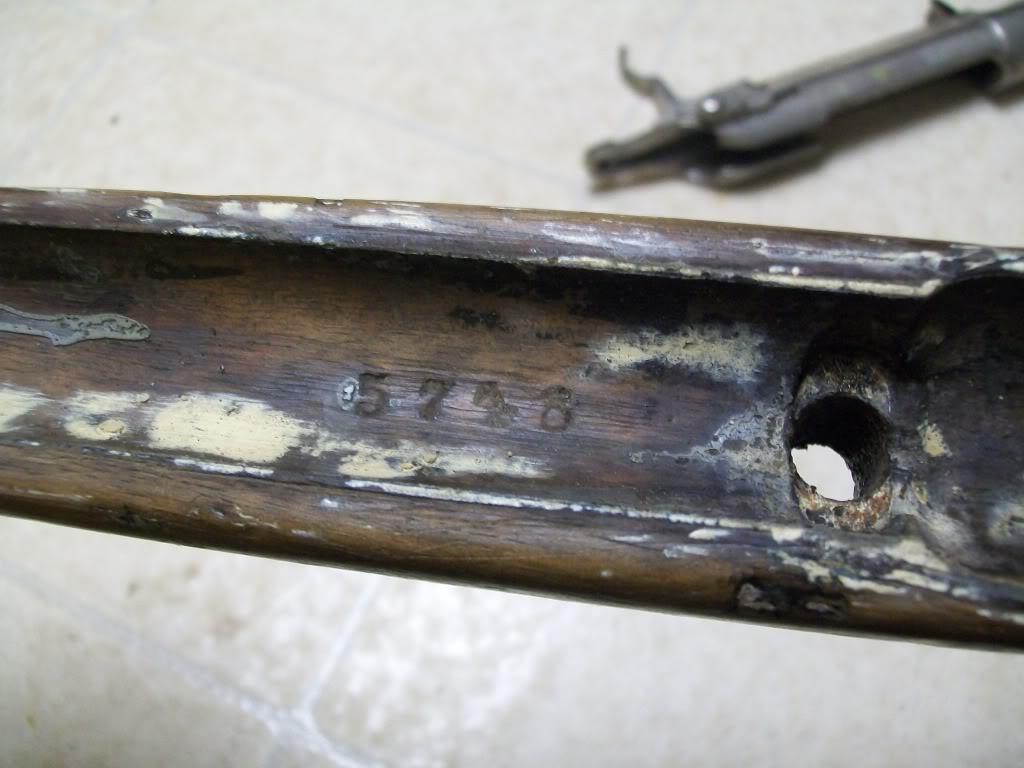

    Anywho.... the white paint actually saved some cartouches:

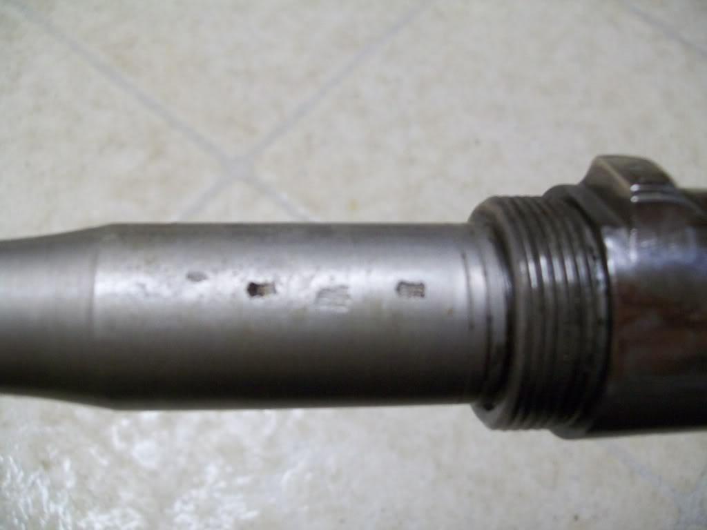

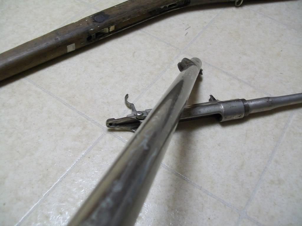

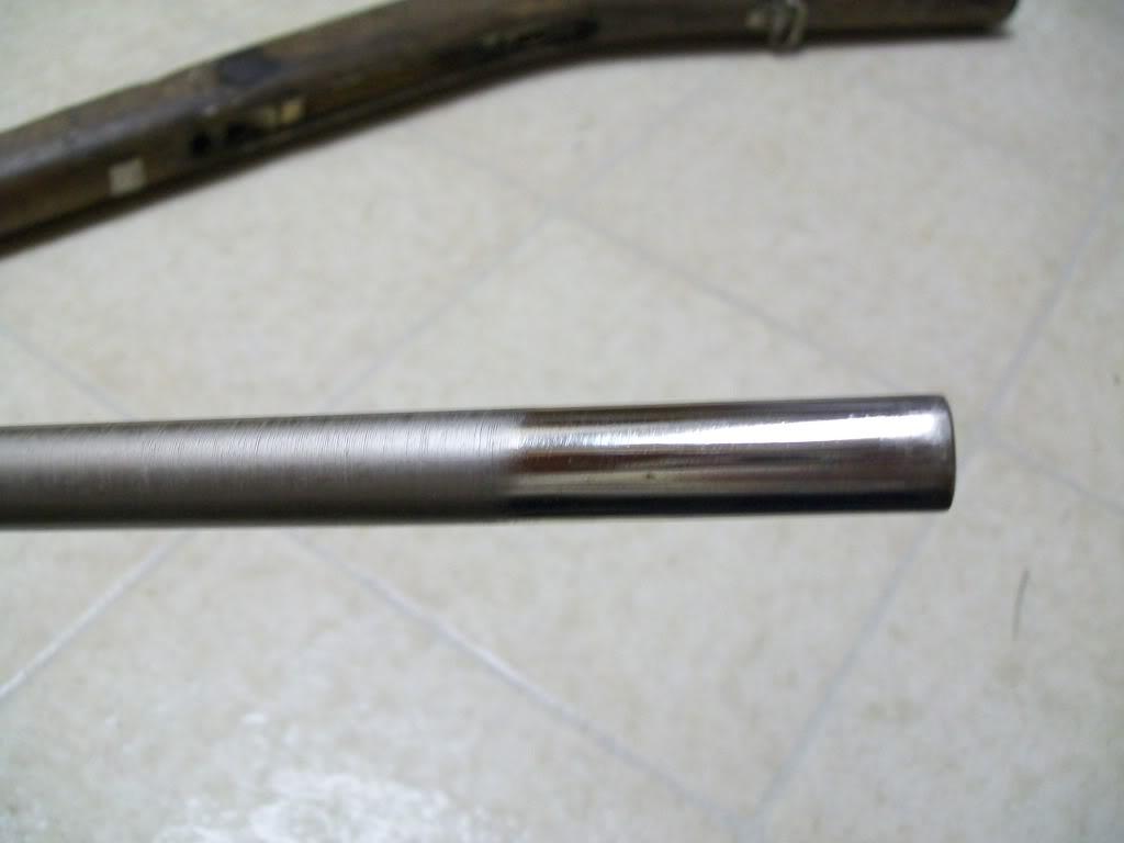

    What is interesting is that the chrome also saved the barrel shroud, and many of the parts...

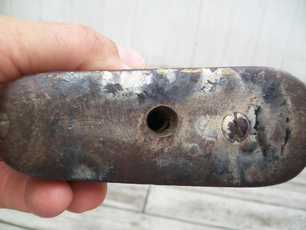

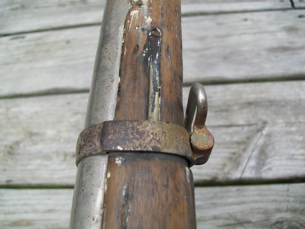

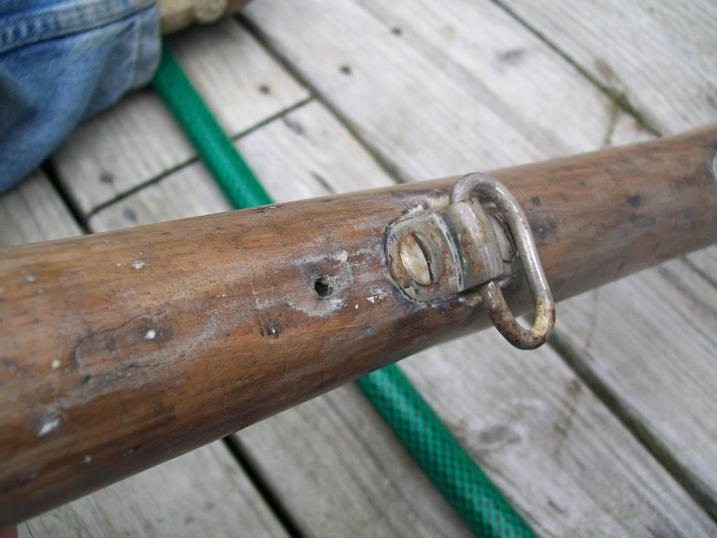

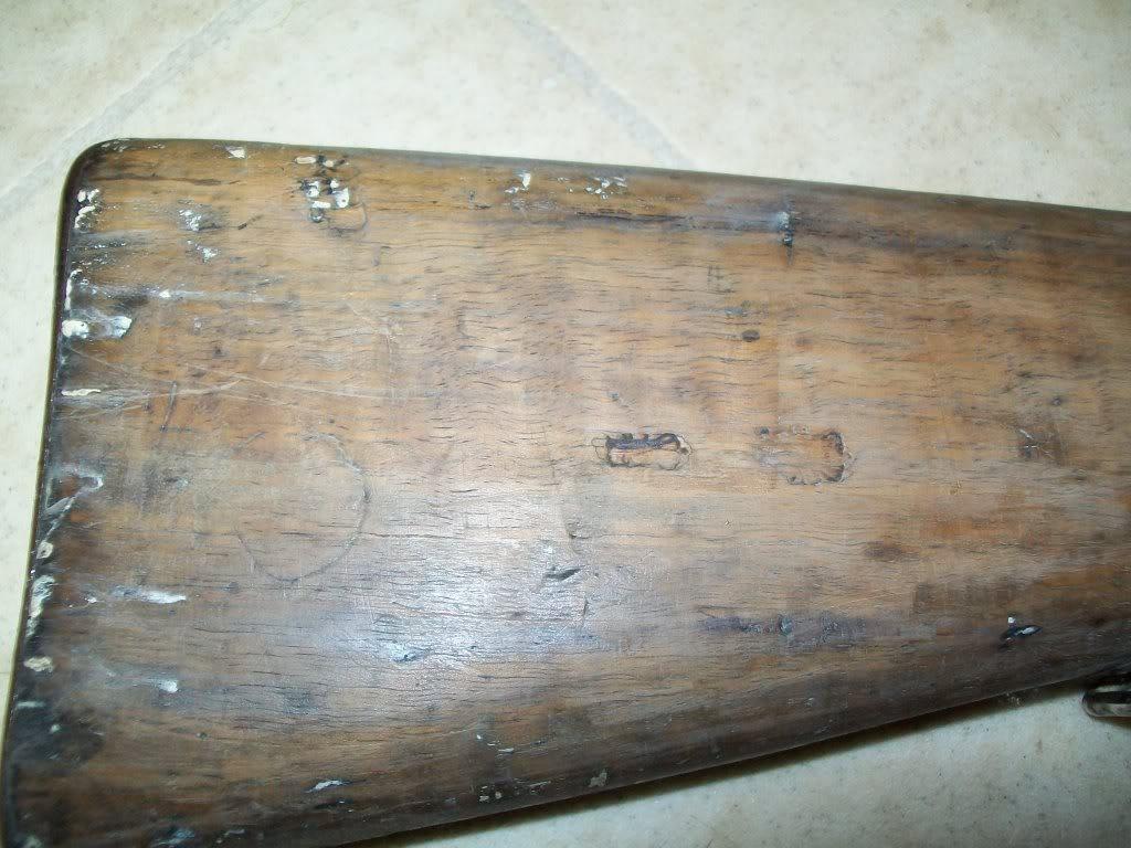

    What is interesting is that the rifle has two holes drilled in the stock:
    So there are several questions to ponder....
    Not in the slightest. The white paint was applied on top of a lot of dings. Ergo done for El Bubba, not El Presidente!

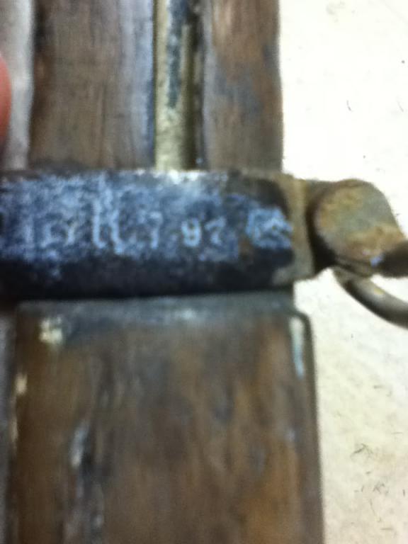

    I can't quite make this out, but this SHOULD be the last Germanicon unit that this rifle MAY have served with. Looking through the chrome and stuff however, I faintly see a "4" which doesn't match the rifle SN, IMHO.
    Where the paint is located...
    Note that I haven't touched this rifle, except to pick it up. The last owner started stripping it down. I do need to start treatment with BLOicon, since if feels dry. In one photo you can see cracking in the "normal areas" for the Gew88.

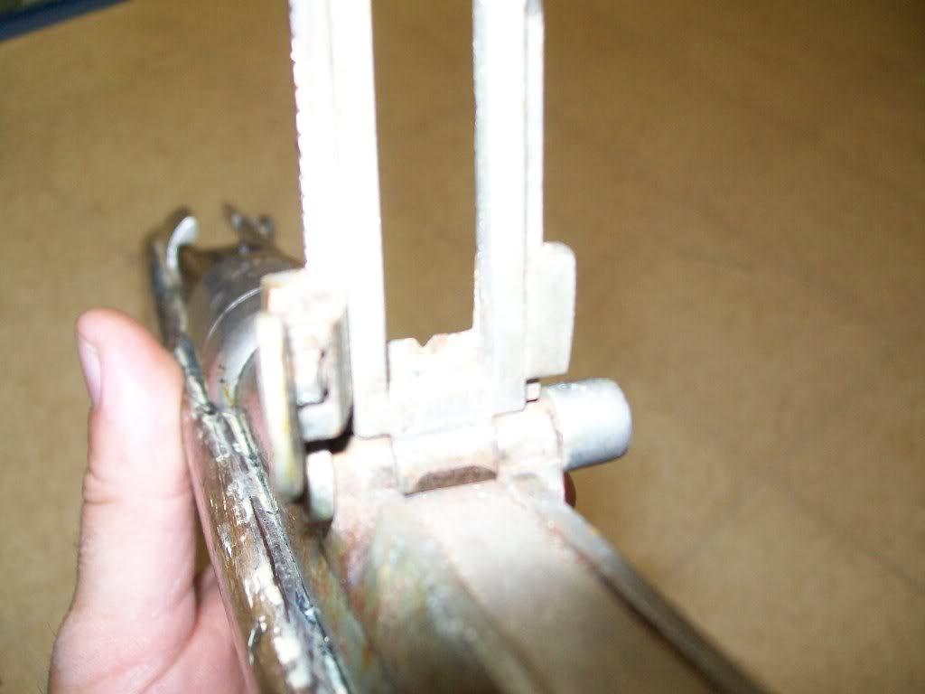

    It does retain the rear sight completely, which I have found to be an oddity. Most are missing part of this sight.

    I do believe this is a first year rifle, as Spandau started making the Gew8 in 1889. Correct me if I am wrong!
    Try getting another photo - but in focus! Back off a bit with the camera - smaller and sharper is better than large and fuzzy. If you can get a clear pic I can probably identify the regiment/unit. At the moment I am guessing I?R.7.97.
    The 7.97 is clear enough. Take the next photo a little further to the left, to get the ??R clearer.
