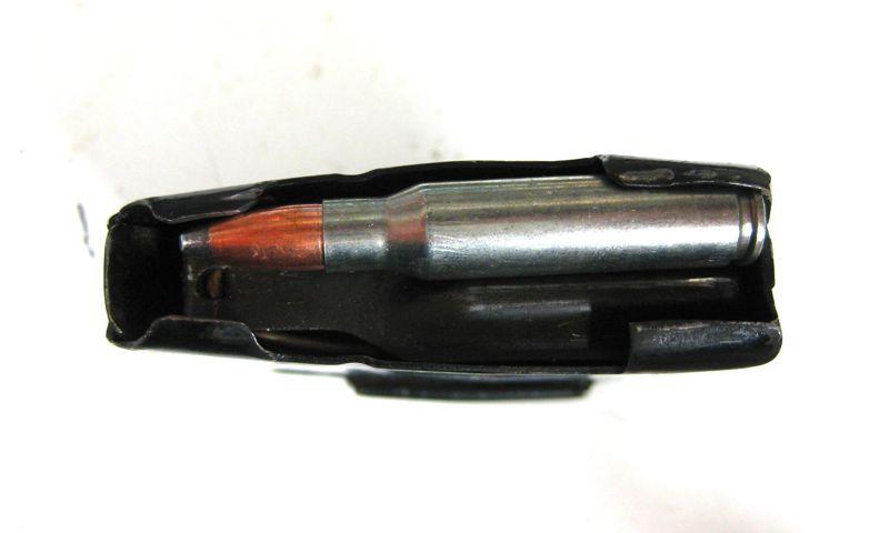

    Thank you all again for some more great info, I had a chance yesterday to shoot the rifle for the first time, just to see what would happen. Conditions were less than ideal, temps in the low 30's and wind gusting into the high 30's. It was cold enough for the bolt to have trouble sliding home too.

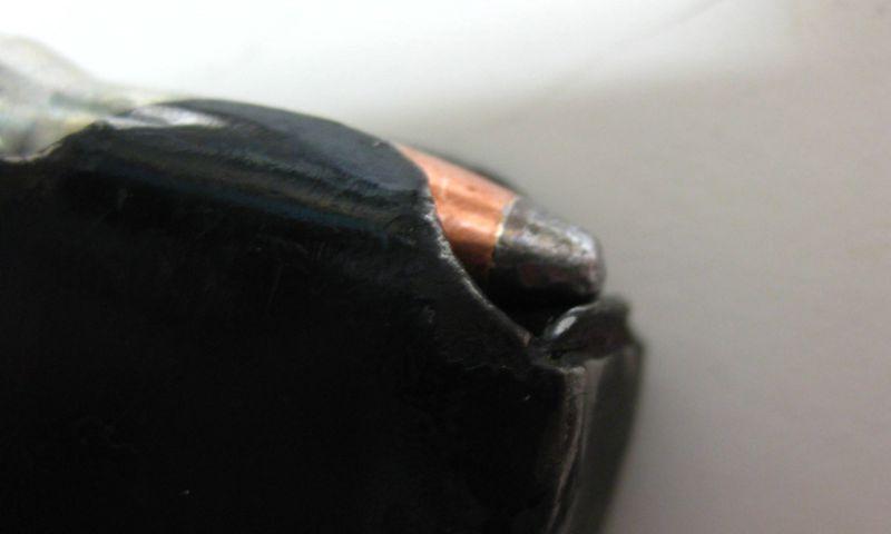

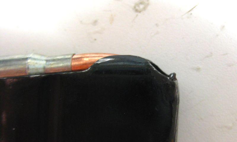

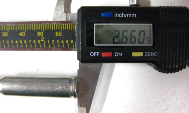

    The only rounds the shop had that would fit were Winchester .308 and I found it impossible to cycle them using the magazine, the bullet tips would catch on the lip at the front of the magazine preventing them from loading into the barrel. The rifle fired and ejected them fine when shot singly. The obvious fix is to file down the lip at the front of the magazine. Finding longer rounds is not going to be practical so is there any reason not to take a file to it? Here's the pictures.

    You won't find a replacement easily when you destroy it by filing it. It just needs adjusting keeping in mind that feeding and ejection on these particular rifles was never great to start with.

    So just bend it little by little until it allows the round to slide up and into the breach?

    05-12-2025
    03:02 AM
    Smooth jaw pliers and dummy rounds are your friend. Bear in mind that part of the problem may be the rear feed lips too not just the front ones. Make sure the magazine snaps tight into the mag well. I've seen some that were so sloppy there wasn't anything you could do short of welding up the rib on the back and starting over again. I've said before that i always considered these rifles to be "Barney Fife" issue. Appropriate since you have Mayberry, NC as your address. "Here's your rifle Sahib. Here's your bullet. Put it in your pocket!"
