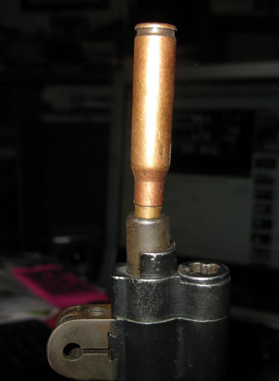

    No point in trying to compare your rifle to a CMPicon Correct Grade; the value is based on originality & condition. Your rifle is a rebuilt mixed parts rifle, & has been altered; as you were advised, value is strictly as a "shooter". Arlington Ordinance was one of the better importers; their rifles came from the Korean Army (which used & badly abused many rifles), but Arl Ord actually evaluated their rifles & often made repairs.
    Value of a shooter would be largely based on condition of the bore. Replacement USGI barrels are virtually nonexistent, but even commercial barrels aren't cheap by the time you pay for labor. Anyone knowledgeable would want a Muzzle Wear measurement. A single round of USGI M2 ball, inserted point first in the muzzle, will let you know how worn the muzzle is, based on how much copper jacket shows.

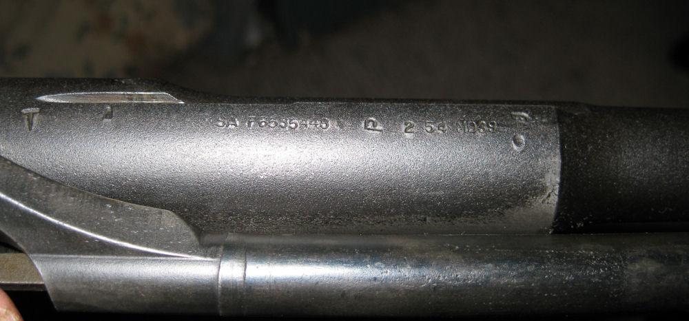

    I've heard of Arlington Ordnance, but that's it. Appreciate the input. What you've written also seems to agree with my experience with this rifle. It's good for hitting what you're aiming at, so things must fit together the way they're supposed to. So, all of the imports are "mixed parts rifles?" How would I tell with mine? Given that the bolt is showing a drawing number or whateveryoucallit, how does one tell? The barrel is dated 2-54, which seems to correspond pretty closely chronologically with the s/n. It has a long series of stamps. I didn't feel like transcribing them, so see the photo below. My bolt's a D28287-12SA (S-B7[diamond] below that). The op-rod's a D35382 S SA. I know the "SA" stands for Springfield Armory.
    Here's a shot of my Garand's barrel stamps:

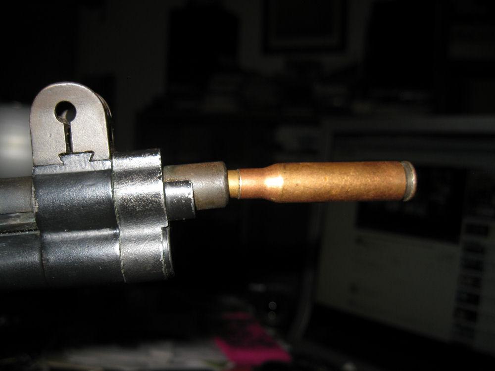

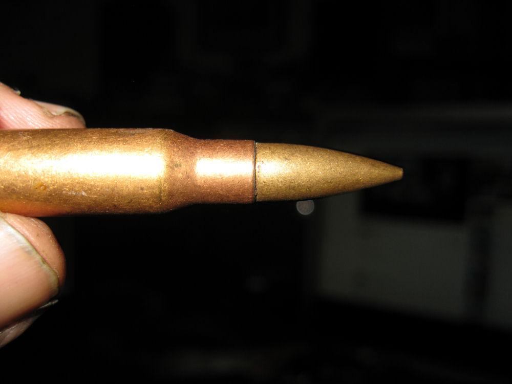

    I don't have any .30-06 loaded right now, but I do have some cheapo Chinese copper-washed 7.62 NATO stuff. Looks like this:
    If I drop it straight into the muzzle, it stops with about 1/8" left to go:
    Holding the rifle horizontally . . . more or less:

    I really wish it wasn't suggested to use a round to test the muzzle, get a gauge.

    Both actions make sense
    Quote Originally Posted by Sarge1998 View Post
    - tells you whether it's even worth checking with a gauge!
    In this case, it looks like it is worth a serious check, so
    get a gauge.
    - is the next step. But if that bullet had disappeared down the muzzle, a gauge would be an expensive waste of time.

    Based on the parts information supplied, they (& the milled trigger guard) are WW2 era parts. Most imports have been rebuilt, so that's not surprising.
    Sorry Sarge, but sometimes a "poor man's Muzzle Wear gauge" is all we have. I don't know if a MW gauge is worth the investment, most folks looking for a shooter will be satisfied with the photos we have seen.
