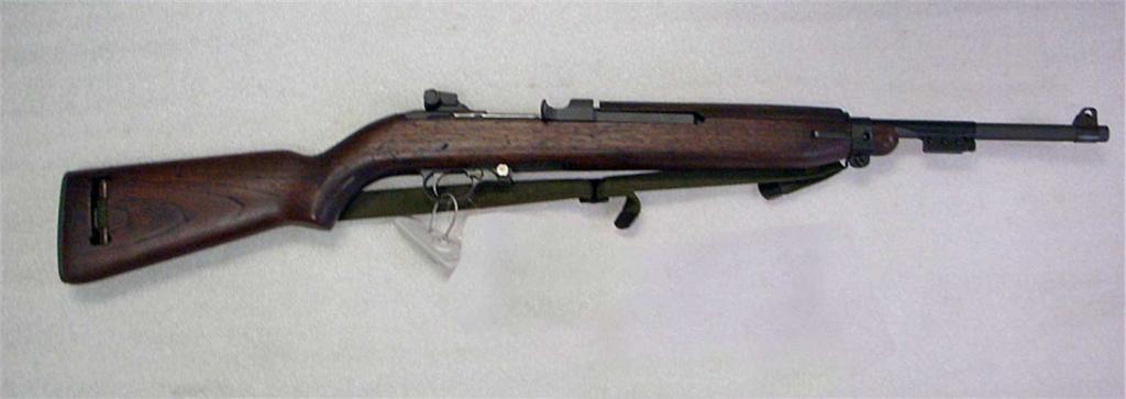

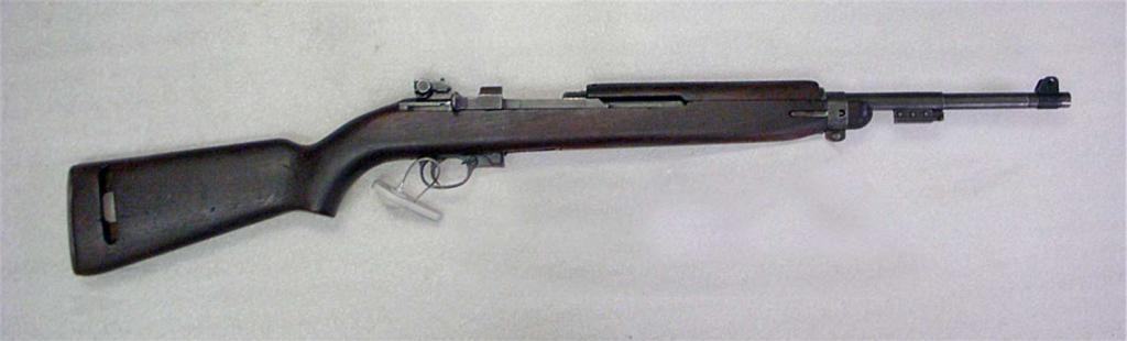

    Seller backed out on the National Postal.
    I'm going to take a look at a Saginaw and Winchester tomorrow.
    Can anything be told from these limited pictures?
    I'll likely buy one of them.
    Winchester
    Saginaw Gear

    There is just so much you can't tell by a picture. Parts and markings, hammer marks, muzzle wear, finish, how smooth does it operate is it gummed up?
    From those pictures it appears both have been through a rebuild.
    The Winchester has more finish wear, SG most likely refinished.
    Winchester has a pressed rear sight, SG has a Milled.
    I cut stock on the SG has a nicer grain then the O cut on the Winchester, but the Winchester doesn't looked cleaned to see very well. Other side usually has rack marks, that is not shown.
    SG has a sling and oiler, Winchester not.
    Both have a flip safety, and type three bands.
    More people want a Winchester name the Saganaw. I would want the best carbine. You need to hold and examine them.
