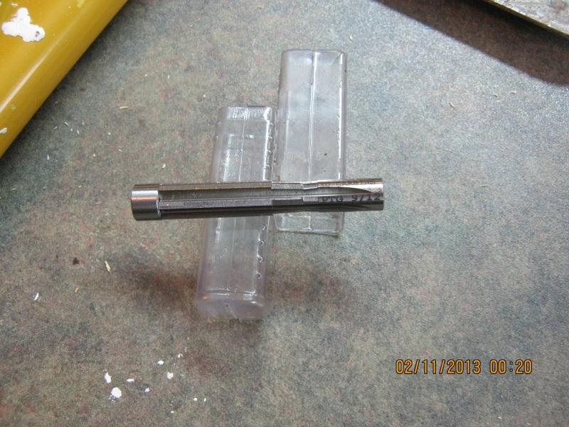

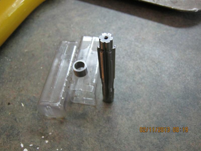

    Definitely stripped if you are using the pull-through reamers of which I'm familiar. The headspace setting "donuts" don't have cutouts. If your reamer is recessed at the back and has a square shoulder it's likely you are missing that spacer.

    Here are some pics of the reamer.

    That's it. Definitely done with the bolt apart.
    Does Pacific offer their own headspace gage?
    Alternatively, can you check the Clymer gage?
    Chamber was for sure clean?
    Will the bolt close easily on a max length cartridge case?
