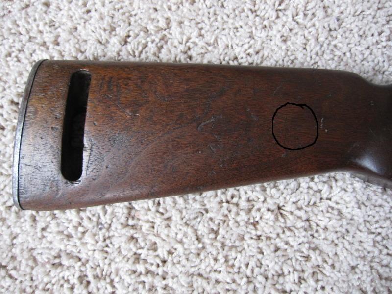

    Try looking very closely in the area I circled for the Stan Pro Crossed Cannons Stamp.
    It is small. Often stamped lightly.
    HTH's,
    CH-P777

    I looked again very closely at the stock and cannot see any hint of a cartouche.
