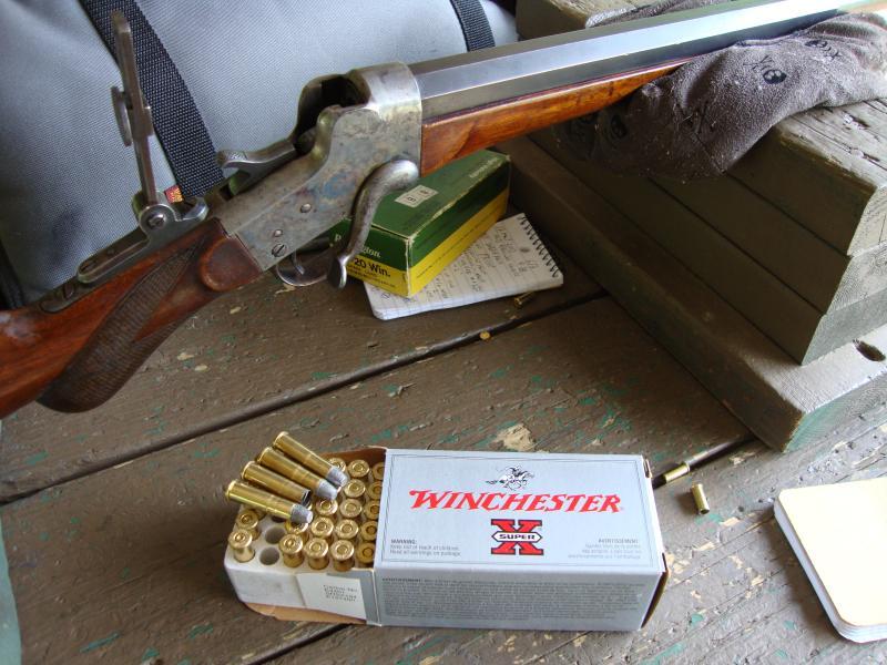

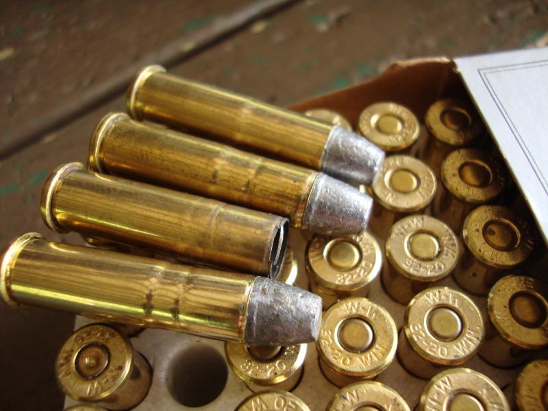

    Thumbs down Factory Winchester 32-20 Ammunition Wretchedness!
    Hands down the worst quality control I've ever seen for commercial ammunition.
    Found a not quite current box of 32-20 W-W ammo and bought it to see if it could match the performance of the 1970s production which is now sadly all gone. Had fired a few without really looking at the stuff with less than stellar results when a case was ejected that had part of the case mouth pulled away! Eh??? Peered at some of the unfired rounds and was, ummm,... disappointed. Stunned. Actually...
    Here's a sample:
    All of this mess is from the same box.
    Crimped so fiercely that the brass failed in some and not crimped at all in others! Have never before seen a crimp that sprang the mouth back out in a flare forward of the impressed ring.
    After range time was over, we checked new W-W mfg. rounds at a local shop: pretty much the same. Hideous! And near on US$1 per round for this trash.
    Fortunately, there's a new lubrisizer at home and 20 sticks of SPG black powder lube freshly purchased along with 100 pieces of new Starline brass.
