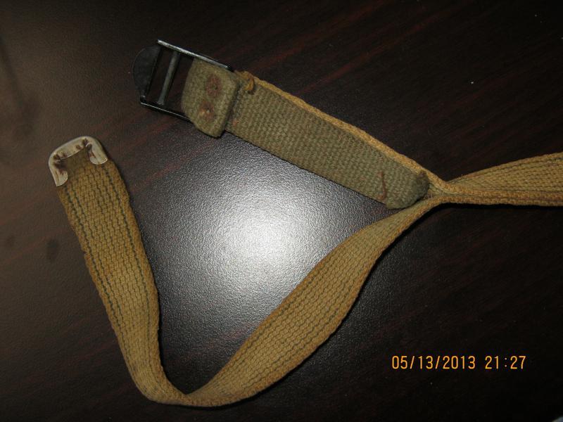

    I pick up a few mags,oilers & a pouche all are G.I. but the pouche I 'm not sure. Would any one now if it is real. on the back of the tab the word United Carr. There was also a sling not M1icon ??? Thanks for any help.

    Pouch looks real to me.

    The strap looks to be a cobbled together equipment strap. Maybe used to be a carbine sling, but no more. The rivets are the star type and I don't think they had anything military about them.

    The pouches appear to be original. But the sling is not USGI for a carbine.

    Quote Originally Posted by Bruce McAskill View Post
    It's not ANYTHING any more. I said it MAY have been for a carbine, but it's been done in. It's now junk.

    The webbing and buckle looks like it might have been from a GI back pack. I had one with those buckles when I was a kid in the 50's. - Bob

    I looked at the sling again. It was put together from parts . Junk for sure. Thanks all for the info.
