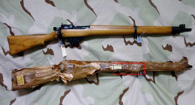

    Re bayonets, from what i've been able to find out, the lump that i have highlighted could well be a bayonet as this is the location in the wrap i was told you can find them.

    Quote Originally Posted by 5thBatt View Post
    Can you tell by giving it a quick grope...? If it is a bayo it should be pretty obvious...maybe...?

    Thanks, 5th, I'll check it when the 10 day waiting period is up.

    That's the middle band and sling loop. Listen......... THEY WERE NOT PACKED WITH BAYONETS. The old VAOS number is on the wrapper for you to see. If there was a bayonet in there, it would be identified by a different ASSEMBLY (B1/CR xx-A) or GENERAL assembly (B1/CRxx-GA) part number
