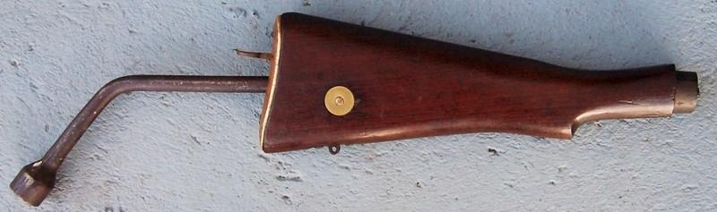

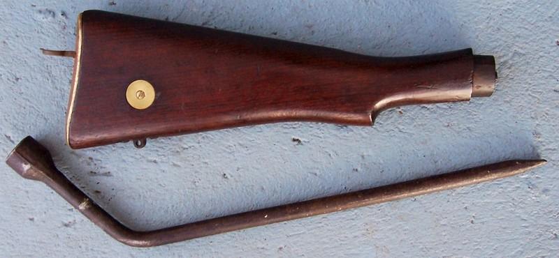

    I use a old wheel brace to undo stockbolts, never failed me yet, in fact it has been used where the correct tool has failed.

    I use a big square shank screw driver from NAPA. Clamp the butt in the vice and put an adjustable wrench on the square shank. That method has never failed.
