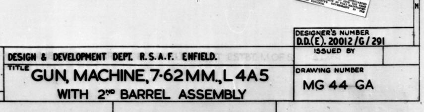

    Not only is there a spec for The A5, it features in the NoD BR's AND their parts list AND we used to see them coming in from the Navy and Marines based down at 'Western District'. And when the A3's are upgraded, there is even an EMER of how to upgrade the bodyside markings and part number.

    Mmmmmmmmmm. Sorry to be a tad contrary KG and BP but a very quick trawl through some of my untidy old paperwork including one Army Code 62189 issued in October 1985 and issued under the authority of the Director General-Defence Quality Assurance Office at...... and you ain't going to believe this........ Royal Ordnance, small-arms division Enfield Lock and another, 62188, both clearly states that the L4A5 is a version of the L4A3 gun and later details the updating process.
    From that and the fact that they were approved for Land AND Naval service (only the A3 but this was extended later to include the A5 and declared the A3 as obsolete for land service but extended for only Naval service. I don't understand all that Naval jargon/waffle either but.....) in Feb 60 and the A5 approved only for Naval service in April '60, I can only assume that, er......... they were approved and exist!
    I KNEW that I'd seen all this in the NoD BR's somewhere! But nice to clear it up. Next question
    And while we're on the subject of Mk2/1's.........
    Enfield refurbished tens of thousands of needy Bren guns of all marks for the War Reserve programme. This included converting Mk2 Brens to what was initially called at the time ‘UPGRADE SPEC’. While it is quite possible that other factories converted Mk2 Brens to Mk2/1 specification, the only Mk2/1 conversions encountered by the author are those from Enfield and BSA Guns. The BSA conversions being marked with the usual ‘ll/1’ marking and ‘BSA-51’ or ‘BSA-52’. Enfield records show that they converted 10,200 Mk2 guns to Mk2/1 specification during the FTR programme. The programme was carried out commencing with the outbreak of the war in Korea in 1950. Many batches were overhauled until the .303” gun FTR programme ceased during 1955, just prior to the 7.62mm X10 programme. Quite how many guns were converted to Mk2/1 specification by BSA and Army Base Workshops is unknown. If it was a further 10,000, then it is still only equates to some 15% of the grand total. Interestingly, while the BSA FTR marks have been encountered, it would appear that these guns were converted on their behalf by Midlands gun-makers Westly Richards who were instrumental in the procurement, refurbishment and re-sale of thousands of war-weary Brens to emergent nations after the war. It is unlikely that a BSA FTR marked gun was for Britishicon Army war–reserve stocks.[COLOR="black"]

    I'm really confused by this, I have the details of a number of L4A3 marked guns, A153 is 1962, A4492 to A5438 is 1965 and A6180 to A7082 is 1966, so the first L4A3 (Marked) guns appeared in 1962, 2 years after the A5 was approved. Yet there were no L4A3 in existence to modify to A5 spec. So why did they make A3s when they could have gone straight to A5 spec?
    Perhaps I'm missing something in the serial numbers, can anyone add to the list below?
    L4A2 1959 to 1960, approx. 10,000 guns
    L4A4 1961 to 1962, approx. 5,000 guns (These maybe actually L4A2, but I've not personally observed an example)
    L4A3 1962 to 1967, approx. 8,000 guns (No L4A2/4 produced in this time)
    L4A4 1968 to 1977.

    I can only repeat what I have read and seen. And then, all I can actually do is quote the books and references. Take it for what it's worth! For example, we already know that the book is very slightly wrong because they say that the A3 is ONE barrel while the A5 is TWO when we know that numerically, that flies in the face of common sense and previously adopted practice. AND the Navy parts list and their equivalent of the EMER. The most important question of course is the one that nobody's asking and it's this. Do you or I REALLY give a xxxx? Maybe this is the difference between the theory and the actual practice. A bit like what they teach you as apprentices and in the EMER and what ACTUALLY happens
    But, as a little rider to this and I was hoping someone would/might mention it is that the Enfield paperwork records say that they commenced the Mk2/1 programme in 1950. But my friend has one distinctly marked 1948. Theory, practice and substantiated fact again!
